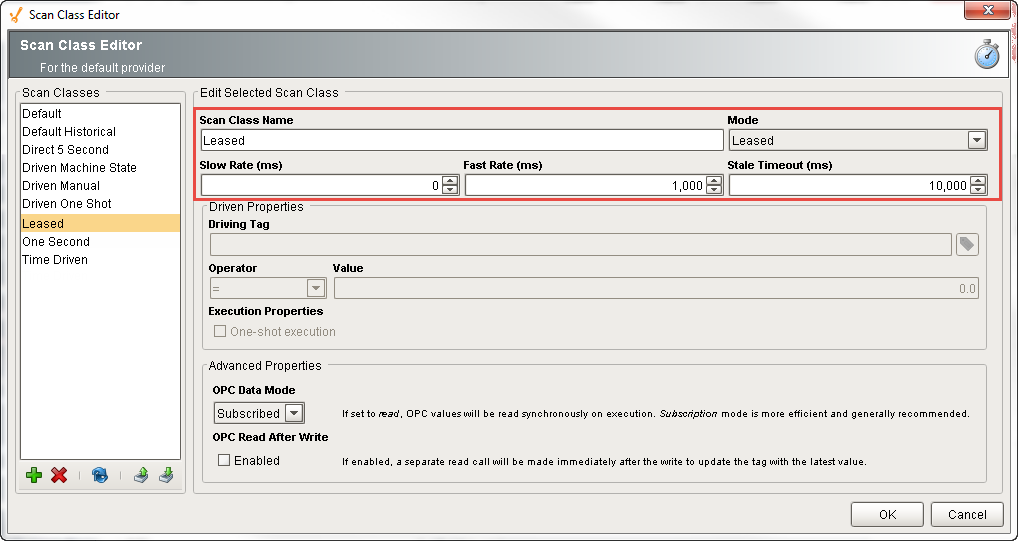

  2. On the left side of the window, you can see all existing scan classes. To create new scan class, click on the green + icon to add a new scan class.
  3. Enter the name of the scan class. For example, name it Leased.
    • Set the Mode to Leased.
    • Set the Slow Rate to 0, and the Fast Rate to 1000, or 1 second.
    • Click OK.

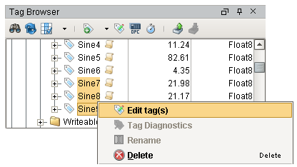

  4. Now, set the scan class on the Tags to use this new Leased scan class. Go to your Tag Browser, find some Tags you want to add to the scan class. This example uses three Sine Tags. Right click on the selected Tags, and click on Edit tag(s).

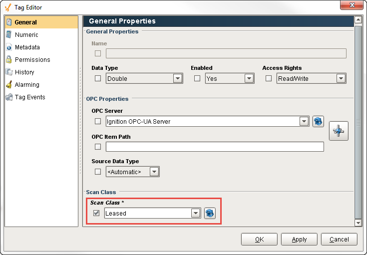

  5. This opens the Tag Editor window. Select the Leased scan class from the dropdown, and click OK.
Now, you just created a new Leased scan class and added your Tags. These Tags are only polled when a component that is bound to it is showing in a Client, or when the Tags are showing in the Designer.
