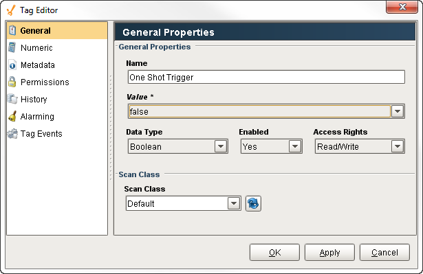

  1. In the Tag Browser, right click on the Tags folder, then go to New Tag > Memory Tag to create a memory Tag.
    The Tag Editor will open.
  2. In the Tag Editor, enter the following:
    • Tag Name: One Shot Trigger
    • Value: false
    • Data Type: Boolean
  3. Click OK to add the One Shot Trigger Tag to the Tag Browser.

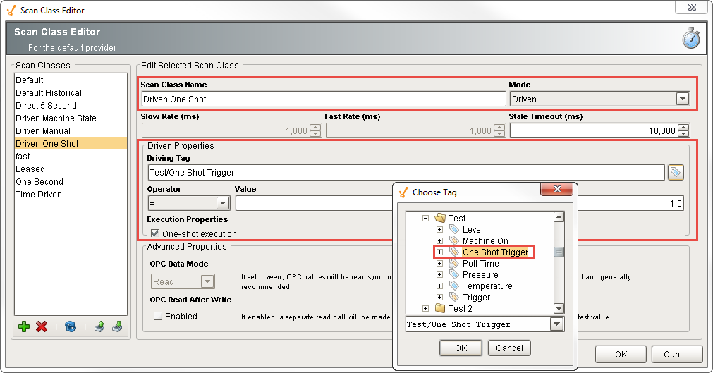

  1. In the Tag Browser, click on the Timer icon (" ") to open the Scan Class Editor.
  2. Create a new scan class by clicking on the green + icon on the lower-left of the window.
  3. Enter the name of the scan class. For example, you can name it Driven One Shot, and set the Mode to Driven.
    This scan class executes based on the condition you set on the Driving Tag.
    Ignore the slow and fast rate since they are not used.
  4. Click on the Tag icon next to the Driving Tag box, and choose the Tag you want to set the condition on, and click OK. This examples uses the One Shot Trigger Tag that was just created.
  5. Set the Operator property to = and the Value property to 1.
  6. Check the One-shot Execution property.
    Click OK.

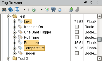

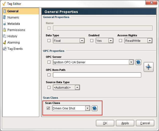

  7. Next, select all the other Tags that you want to run in this scan class (i.e., Level, Pressure, and Temperature).
    Right click on the selected Tags, and the Tag Editor will open. To change the scan class, choose Driven One Shot from the dropdown, and click OK.

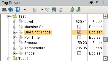

  8. In the Tag Browser, check the One Shot Trigger Tag to set the value to true, and you will see the values update once, and then stop.
    Uncheck the One Shot Trigger Tag, to set the value to false, and check it again to set it to true, and you will see the values update again.
