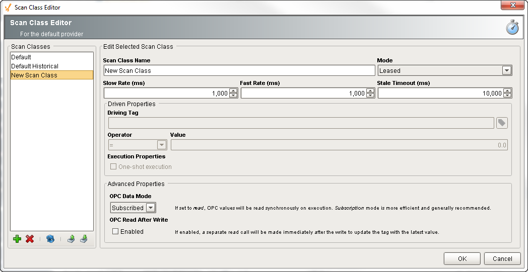

A screenshot of the Scan Class Editor is shown below. Each Scan Class Editor property is described in detail in the table below.
Scan Class Editor​
Settings that edit a selected scan class.

Slow RateBase update rate, specified in milliseconds, at which Tags will be executed.
Note: If the rate is set to 0, the scan class will not be executed. It is common for leased and driven modes to use 0 as a slow rate in order to achieve an on/off effect.
Fast RateUsed by the Driven and Leased modes, this is the faster rate that the Tags will be executed at when those modes are active.
Stale TimeoutHow long to wait before the Tags in the scan class are determined to be stale (not running). This is calculated off of the last expected execution time of the scan class, and is particularly important for scan classes executed by other drivers through the external Tags provider. This property is not used by internal providers.

Driving TagWhich Tag will determine when the rate of the scan class should be changed.
The Driving Tag should not use this same scan class. The Driving Tag should be on a separate scan class that runs at a faster rate than the Driven scan class. This means that changes to the Driving Tag will be recognized by the system faster, and the change in rate on the Driven scan class will occur faster.
OperatorHow the Value property should be compared to the Driving Tag's value. If the comparison is true, then the Fast Rate will be used by the Scan Class ,otherwise, the Slow Rate will be used.
The Any Change operator works differently than the other operators: The scan class will execute immediately whenever the driving Tag changes value. Using the Any Change operator means that the scan class no longer uses the Slow Rate or Fast Rate properties.
ValueUsed by the Operator property to determine if the Scan Class should execute at the slow or fast rate.
One-shot executionOne-shot will execute once when the comparison condition is true, and not again until the condition become false, and subsequently true.

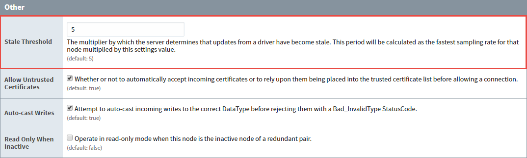

Ignition uses the OPC-UA Stale Threshold setting to determine when updates from a driver have taken too long to complete. This time period will be calculated as the fastest sampling rate for that node multiplied by the Stale Threshold setting value. It's this multiplier on the scan class that determines when the Tag can be marked as stale or not. The default for the Stale Threshold value is set to 5. This is a very important setting because when the network is going slower or the PLC is taking a long time, those Tags need to be marked in Ignition as stale so that the operators know not to trust those values on the screen.
note
The OPC-UA Stale Threshold is one setting is for the entire Ignition server.
To Edit the Stale Threshold​
  1. Go to the Configure section of the Gateway, and select OPC-UA Server > Settings.
    The Settings page is displayed.
  2. Scroll down to the Other section and then to the Stale Threshold setting.
    This is a multiplier by which the server determines that updates from a driver have become stale.
