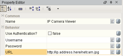

Finding the URL for your network camera's video stream is usually the only challenge in connecting this component. Most, if not all, network cameras have an internal web server, allowing viewers to use web browsers to view their video stream. If you go to that webpage, and look at the HTML source of the page, you should be able to find the URL of the MJPEG or JPEG still stream.

PasswordThe password to authenticate with.String.passwordBehavior

URLThe HTTP URL of the video stream to display.String.urlBehavior
Use Authentication?If true, the URL connection will try to authenticate using the given username and password.boolean.useAuthenticationBehavior
User-AgentIf non-empty, the HTTP User-Agent to spoof.String.userAgentBehavior
UsernameThe username to authenticate with.String.usernameBehavior

StarDot Netcam (JPEG stills)
http://ip.address.here/netcam.jpg
