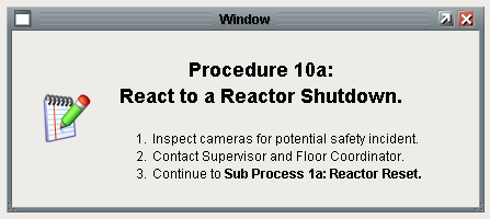

Stylized Label Inside a Popup Window​
Properties
  • Image Path: Builtin/icons/48/edit.png
  • Text: Shown below:
<html><p><strong><center><h2>Procedure 10a: <br>
React to a Reactor Shutdown.</h2></center></strong></p>
<ol>
<li>Inspect cameras for potential safety incident.</li>
<li>Contact Supervisor and Floor Coordinator.</li>
<li>Continue to <strong>Sub Process 1a: Reactor Reset.
</strong></li>
</ol></html>
