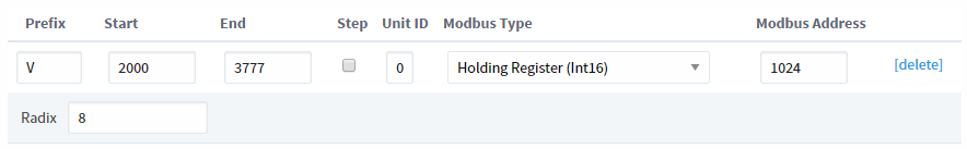

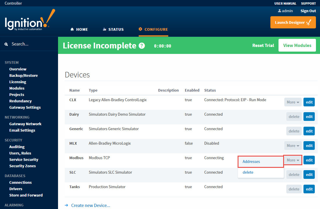

To specify the address mapping​

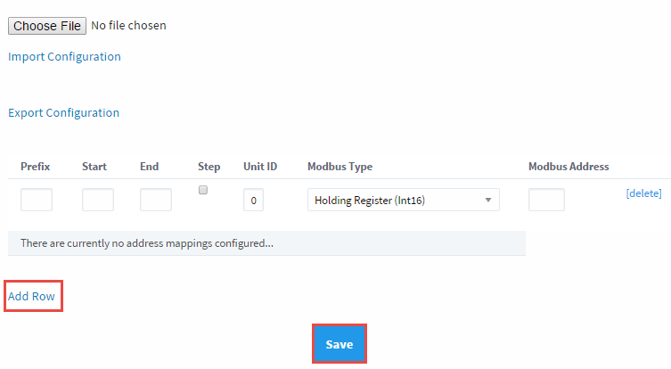

  1. Go to the Configure section of the Gateway webpage and under OPC-UA Server > Devices, click on the More button and select Addresses to the right of your Modbus device.
  2. Click on Add Row.
  3. Enter the mapping as follows:
    Prefix: V
    Start: 2000
    End: 3777
    Modbus Type: Holding Resister (int16)
    Modbus Address: 1024
    Radix: 8 (8 causes the addresses to be in octal, also known as base 8)
    These settings map the Modbus address range V2000 to V3777 in octal to Modbus Holding Register addresses 1024 to 2047.
    note
    The mappings for string data types cannot be entered. Strings can only be read or written using Modbus Specific Addressing.
  4. Click Save.

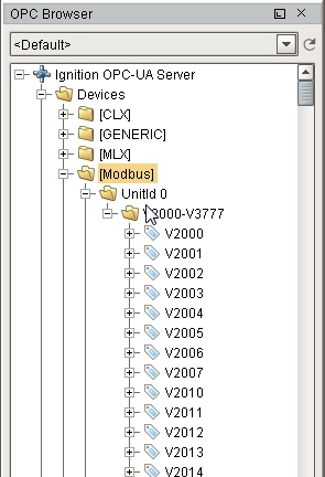

  5. Go to the OPC Browser in the Designer or the OPC Connections > Quick Client (on Gateway) and open the Modbus folder.
    You can now see all the Modbus addresses from V2000 to V3777 in octal.

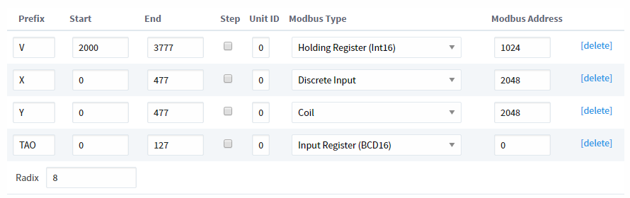

    Here is an example of mapping for all of the Modbus DL240 addressing:

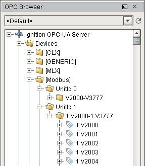

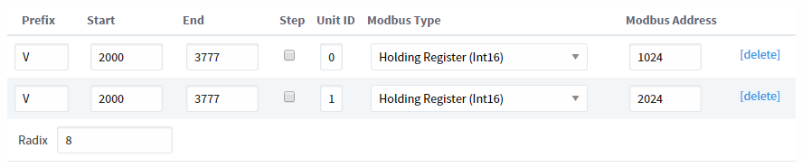

Address Mapping Multiple Devices​
It is not recommended to communicate to multiple Modbus devices through a Modbus Gateway where Gateway has the same address. Therefore, do not add multiple Modbus devices with the same IP address.
Only add one Modbus device to the Ignition OPC-UA Server device list for Gateway and specify the different unit IDs in the address mapping. The unit ID is specified for each entry in the address mapping for the Modbus device. Notice in the example below, the Prefix, Start, End, Modbus Type and Modbus Address can be the same for two entries provided that the Unit IDs are different.
Now when browsing the Modbus device, the unit ID will show as a folder and the OPC tag path includes the unit ID as shown below. This only happens when more than one unit ID is specified in the address mapping otherwise the unit ID is eliminated.

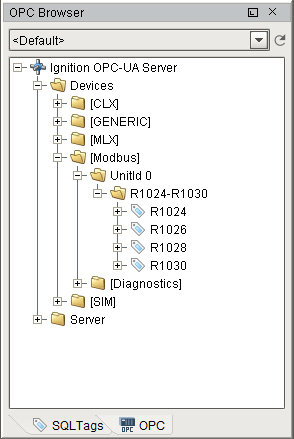

The Modbus address mapping below shows how to map float point addresses starting at 1024 and ending at 1030. With the box in the Step column checked, the addresses on the Ignition side will index by 2. In this case, R1024, R1026, R1028 and R1030 will be created.
Because Modbus Type of Holding Register (Float) is selected, the driver will read two consecutive 16-bit words and convert it to a floating point value. It also indexs the Modbus Address by 2 for each entry. In this case, R1024 reads from Modbus addresses 1024 and 1025 and converts them into a floating point value. When writing, the reverse of converting a floating point value into two 16-bits words is done before sending them to the device.
The following window shows what is displayed in the OPC Browser. Notice that the numbering is indexed by two and that it matches the Modbus address. With some devices, this allows the addresses displaying in the OPC Browser to match the addresses in the device.
