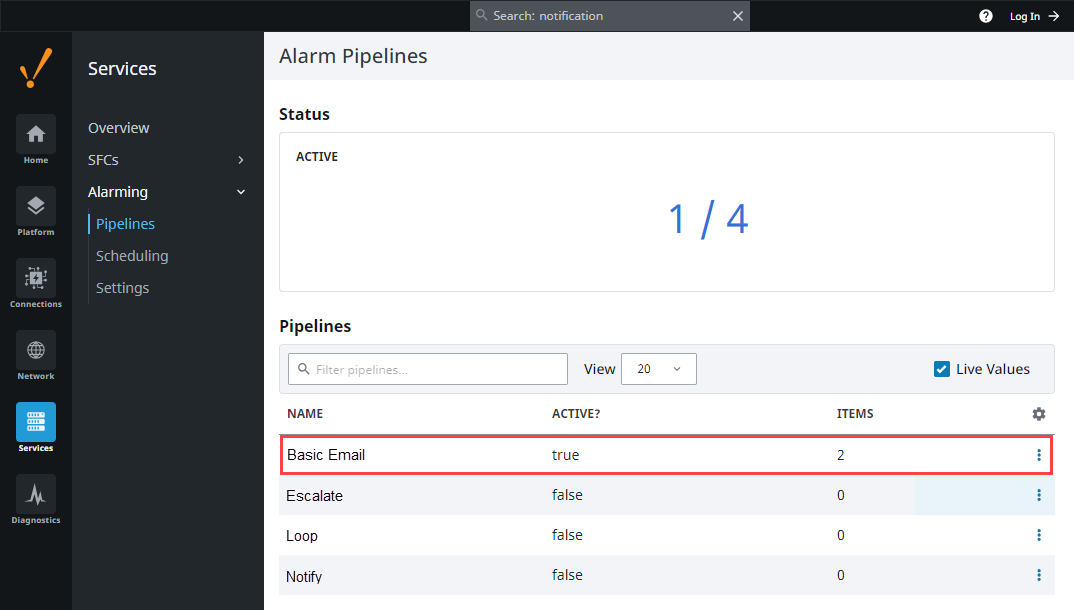

  1. Go to the Services tab of your Gateway Webpage and on the left side of the navigation bar, click on Alarming > Pipelines. The Alarm Pipelines page will open and display the status of all your Alarm Pipelines. This example shows four pipelines with one active pipeline for Basic Email and three inactive pipelines.

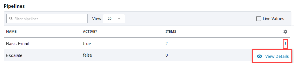

  2. To see a detailed status of any of your alarm pipelines, click the three dots menu and select View Details.
  3. A Details panel will appear for the pipeline and show the Source, Display Path, Pipeline Block, Status, and the length of time stuck in a pipeline block for each active alarm. You can Cancel the alarm to delete it from the pipeline, and view the logs by clicking on the Pipeline Logs tab.
