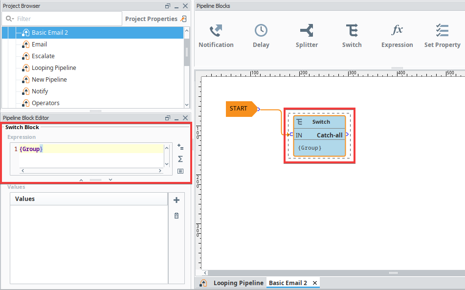

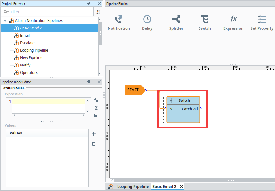

  5. For this example, drag in the Switch block to your pipeline, and connect the Start block to the IN of the Switch block. There are two blocks that can be used for filtering, either the Switch block or the Expression block. The Switch block allows you to switch on a value and do something different for Group A and Group B. The Expression block does the same thing, but only returns values of True or False.

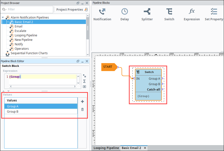

  6. In the Pipeline Property Editor, you have to manually enter the expression because you will not find any of the associated data properties in the dropdown list. Enter the name of the associated data property in curly braces, such as {Group}. The Group associated data property acts as a placeholder for the real values.
  7. Next, you need to add some values to the expression. You can add as many values that you have values for. Click on the Add icon and add two values: Group A and Group B. Once you enter both values, you will have outputs in the Switch block for Group A, Group B, and by default, Catch-all. Now you can notify a different list of people based on each Group.

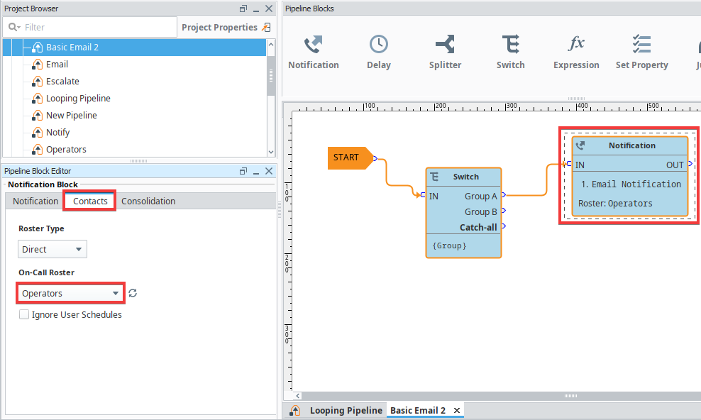

  8. Drag a Notification block into your pipeline, and connect the output of Group A in the Switch block to the IN of the Notification block.
  9. In the Pipeline Block Editor, under the Notification tab, choose Email Notification as your notification type.
  10. In the Contacts tab, under the On-call Roster icon, select the roster you want to notify (i.e., Operators).

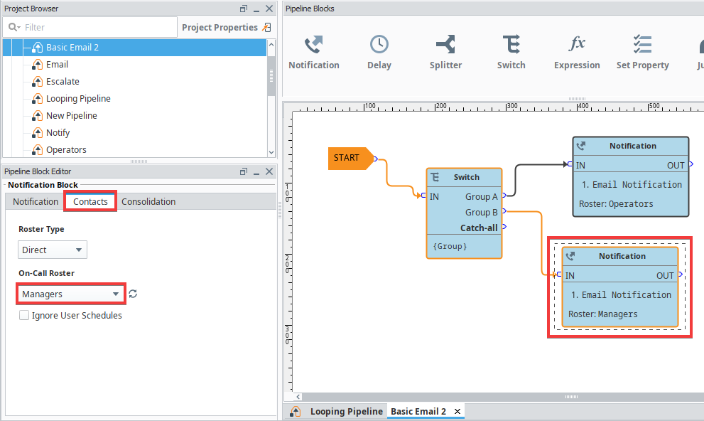

  11. Drag a second Notification block to your pipeline, and connect Group B from the Switch block to the IN on the second Notification block.
  12. Choose Email Notification as your notification type, and specify a different On-call Roster to notify a different group of people. We will be using the Managers roster in this example.
