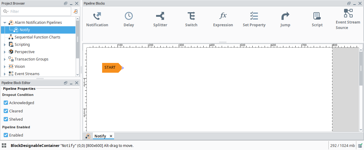

Start Block​
When you create a new pipeline, you always get a Start block placed in your Pipeline Workspace. You cannot delete the Start block because it represents the entry point for alarm events into the pipeline.

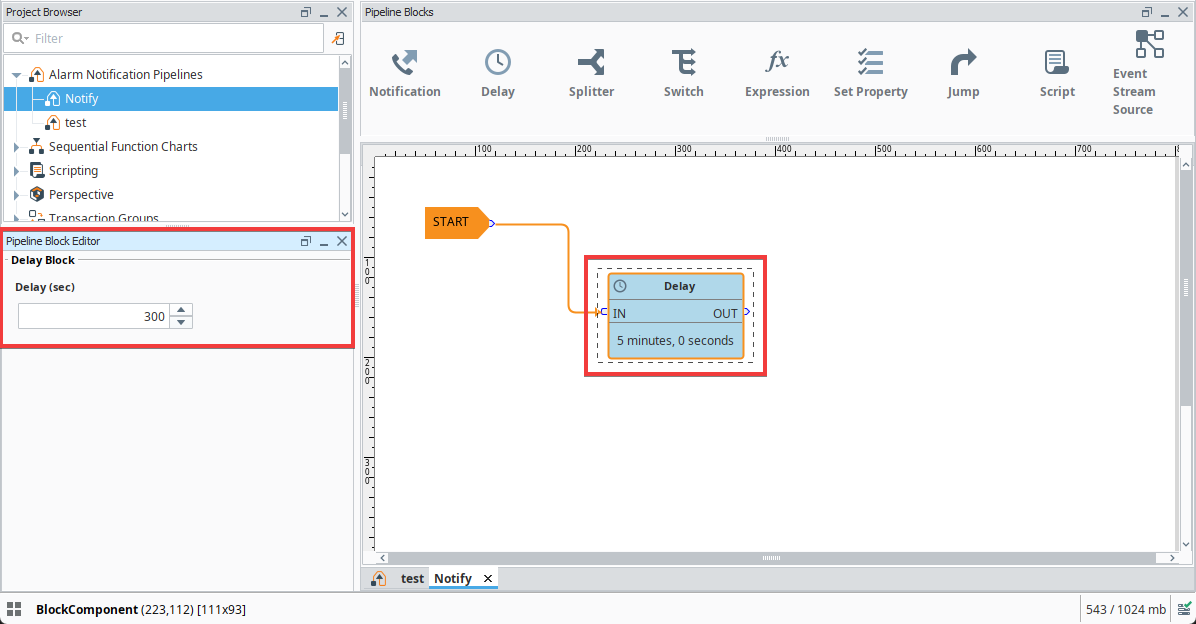

Delay Block​
The Delay block simply blocks alarm events for a specified period of time before moving them to the next block. They are generally used to wait for the dropout condition to become satisfied for an alarm.
For example, a 5 minute delay might be used to give operators viewing control screens a chance to acknowledge, and only send notifications if they haven't (the "active delay" deadband on the alarm could be used to delay the alarm as well, but in that case it wouldn't actually be active, and therefore not displayed, for the delay time).
Delays are often also used to control flow in a pipeline. For example, in an "escalation" scenario, a notification block might be used to send emails. Since emails are sent instantly, and acknowledgment occurs "asynchronously" (the user must see the email and click the link or log into the system), a delay block could be used to provide time for the user to acknowledge, before moving on to a voice notification block. There is no practical limit to how long a delay can be. The delay is calculated independently for each event entering the block, meaning that each event will be held for the specified time.
Click the Delay block and a spinner will appear in the Pipeline Block Editor. You can specify the number of seconds to delay. In this example, if you enter "300" seconds, the alarm will wait 5 minutes before sending the notification to Roster A.
Delay Block

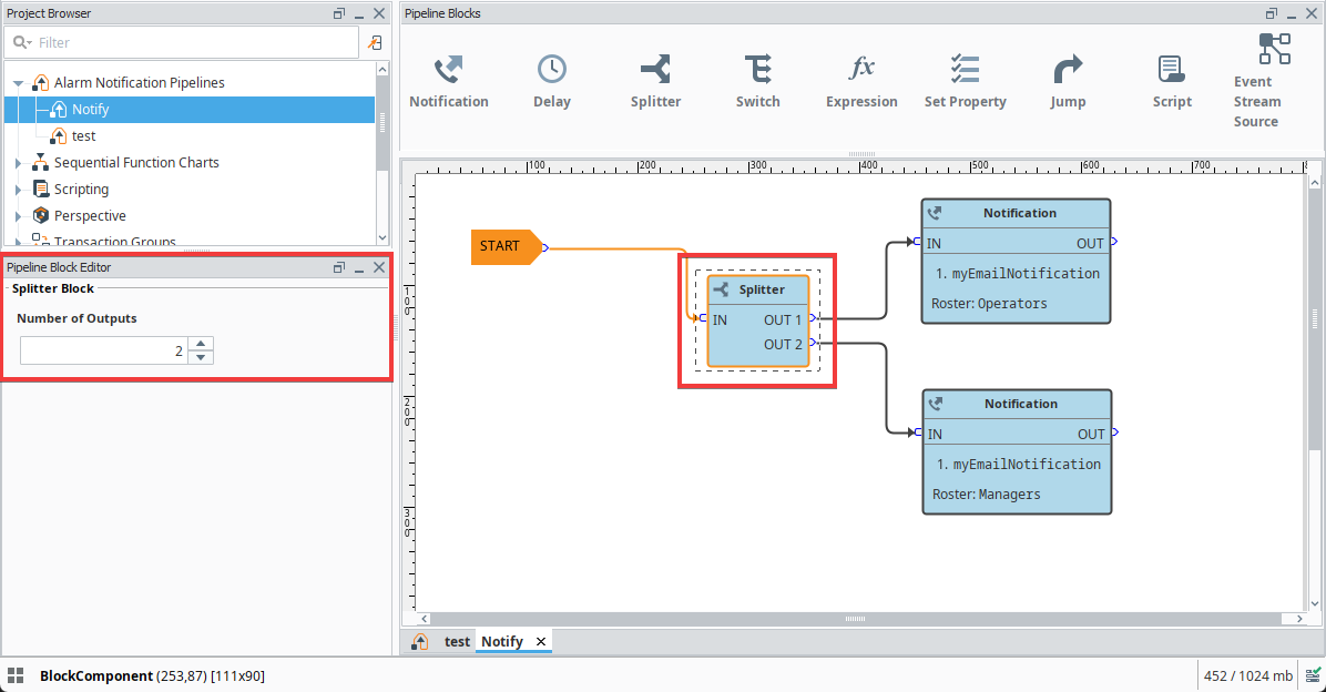

Splitter Block​
The Splitter block simply forwards a single alarm event to multiple outputs at the same time. It creates a copy of the alarm event for each output and executes the alarm notifications along multiple paths in parallel. You can specify as many outputs as you want. If care is not taken, it is possible to end up with an exponential number of alarm event copies active in the pipelines at one time. Since each notification block operates on a specific on-call roster, splitters are useful for delivering events to multiple notification blocks at once as shown in this example.

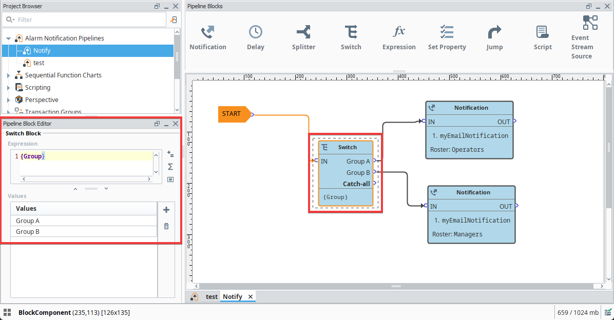

Switch Block​
The Switch block evaluates a non-boolean expression and forwards it to an output based on a given result. It can be a number or string, and it will be looked up against a defined list of expected results. If a match is found, the alarm will follow that path, otherwise the "Catch-all" output is used.
You can create an expression and even use the alarm event's priority, associated data, value and more. The following example has associated data for the Group that they belong to with "Group A" and "Group B" values. The Switch Block will evaluate the expression results against these defined values, and if a match is found, the alarm will follow that path. If neither of the values are met, the Catch-all output will be used.
This example demonstrates that a pipeline can send out an alarm to two different lists of people based on the group.

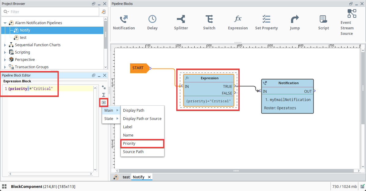

In the Pipeline Block Editor, you can select the Alarm Properties from any of the icons in the Expression block. This example uses an expression to check to see if the priority is Critical, and if so, the alarm notification will follow the True path. If it is not Critical, it will follow the False path. As you can see, the False output is not configured. You don't have to configure every output if you don't want to.
Priority Expression Example
{priority}="Critical"

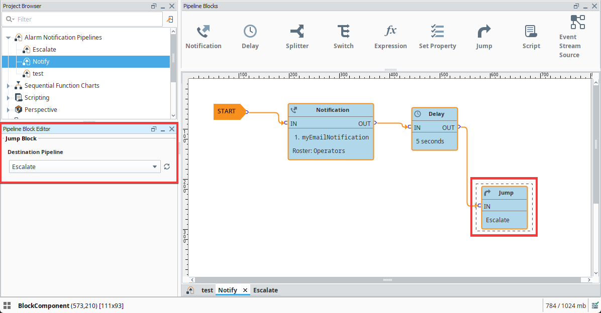

Jump Block​
The Jump block forwards an alarm event to a different pipeline. You can breakup a pipeline into several different pipelines and use the Jump Block to go back and forth between pipelines. This is perfect for an escalation pipeline because often times they can become one massive pipeline, and the Jump block can make the escalation pipeline less complicated and more compact.
In the Pipeline Block Editor, enter the Destination pipeline called Escalate.
In this simple example, the Jump block forwards the alarm to the Escalate pipeline and ends there.

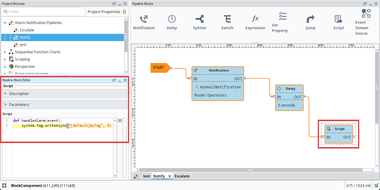

Script Block​
The Script block allows you to execute a task outside the pipeline like writing to another alarm tag or database. In this example, the Script block was used to notify the production supervisors of an alarm using another alarm tag as shown in the Pipeline Block Editor.
The script block provides access to an event object, which is simply a ScriptableBlockPyAlarmEvent object.

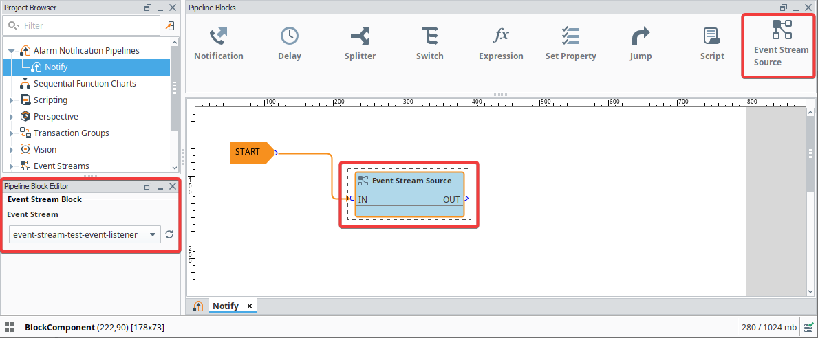

Event Stream Source Block​
The Event Stream Source Block allows you to send alarm event data to an event stream that is using an event listener as a source. Then, based on handler setup, the event stream will manipulate the alarm data as desired.
The alarm event data from this pipeline block will be an AlarmEventObject, containing extractable metadata similar to other event stream sources .
