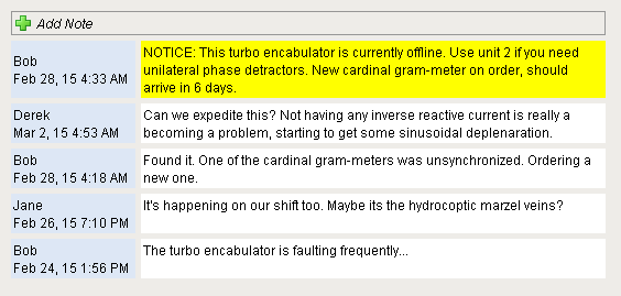

The comments panel is used to power a blog-style comments system within your project. This can be useful for ad-hoc collaboration and communication between shifts, remote users, etc. This component is driven by a dataset that should be bound to a SQL query. Unlike most components, this component has built-in functionality to alter an external database. It expects three tables in the database, and that they are queried properly on the data property.
You can opt out of this three-table default system by simply making use of the Extension Functions on the component. See below for more details.

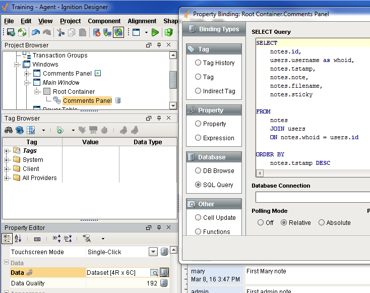

Example
The following query returns note data from the above tables, and displays the data on a Comments Panel component. This query should be placed in a SQL Query binding on the Data property
SELECT notes.id, users.username as whoid, notes.tstamp, notes.note, notes.filename, notes.sticky
FROM notes JOIN users ON notes.whoid = users.id
ORDER BY notes.tstamp DESC
