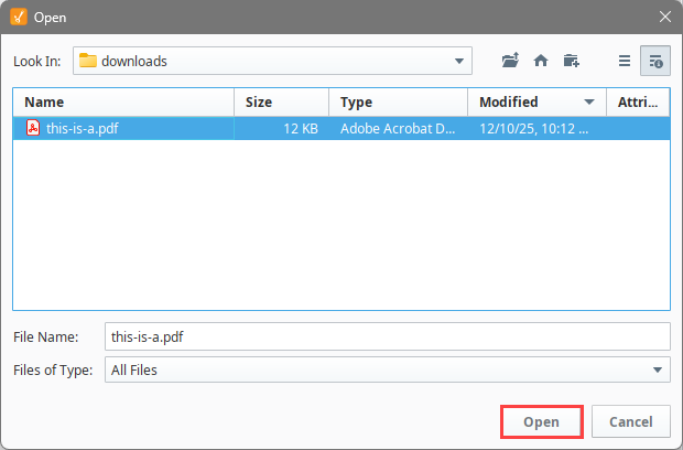

  5. On the top navigation bar in the Designer, toggle the Preview icon to enable Preview Mode.
  6. Click Browse on the File Upload component
  7. Select a file to upload and click Open.
  8. A message will appear indicating a successful upload.

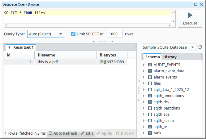

When a file is uploaded, the script stores the file name and bytes in the files table.

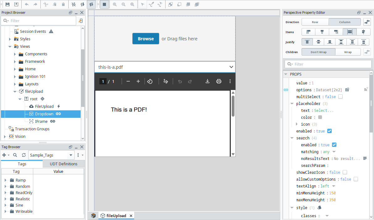

Displaying PDF Files in Perspective​
Perspective includes a built-in PDF Viewer component that displays PDFs hosted at a URL. When a PDF is stored directly in a database as binary data, however, it does not have a web-accessible address that the browser can load. In this example, the stored file bytes are retrieved from the database, encoded as Base64, and converted into a Data URL that can be passed to a component capable of rendering the content, such as an Inline Frame.
info
Large PDFs may exceed browser memory limits when rendered as Base64. For large files, consider exposing the content through a WebDev endpoint instead of a Data URL.
  1. Create a Named Query that returns the file name and bytes for a selected file:
    SELECT fileName, fileBytes
    FROM files
    WHERE id = :fileID
  2. Add a Dropdown component to the view and bind its options property to a Named Query that returns available file IDs and names. This example uses the following Named Query.
    SELECT id, fileName
    FROM files
  3. Add an Inline Frame component to the view. This component will be used to display the PDF after it is retrieved from the database and converted into a Data URL.
  4. Bind the Iframe src property to the Named Query that returns the fileName and fileBytes columns.
  5. Add a script transform to the binding that converts the returned file bytes into a Data URL.
    import base64
    # Expect a dataset with a "fileBytes" column
    if value is None or value.getRowCount() == 0:
    return ""
    fileBytes = value.getValueAt(0, "fileBytes")
    encoded = base64.b64encode(fileBytes).decode("utf-8")
    return "data:application/pdf;base64," + encoded
Now, when the user selects a file in the Dropdown, the Named Query returns the stored bytes. The transform converts the bytes into a Base64-encoded Data URL, and the Iframe renders the PDF in the browser.
