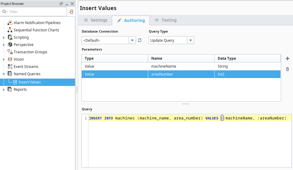

  3. Open the Named Queries workspace from the Project Browser.
  4. Enter Insert Values into the New Query name field.
  5. Select Update Query.
  6. Select the Authoring tab.
  7. Update the two default Value type Parameters.
    1. Rename the first value to machineName and leave the data type as String.
    2. Rename the second value to areaNumber and change the data type to Int2.
  8. Enter the following Named Query statement:
    SQL - Insert Values
    INSERT INTO machines (machine_name, area_number) VALUES (:machineName, :areaNumber)
