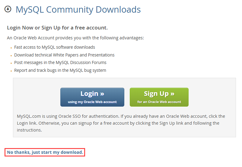

  1. Go to the MySQL website at https://dev.mysql.com/downloads/mysql/.
  2. Click the Download option for Windows (x86, 64-bit), MSI Installer.
  3. You can login or create an account before downloading if you'd like. Otherwise, click No thanks, just start my download.
  4. Once the .msi file is downloaded, run the file to begin the installation process.
  5. Complete the MySQL Installer steps until installation is complete. At minimum you'll want to install both the server (the actual database) and MySQL Workbench (an application that allows you to quickly and easily interact with the database, without using a command-line client). Any other items beyond these two are generally unnecessary in most environments.
