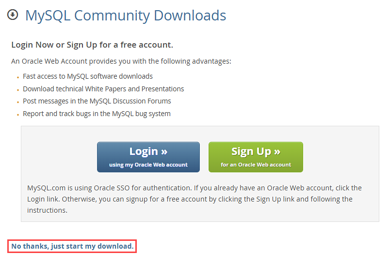

On the next page, you can login or create an account if you'd like. Otherwise click No thanks, just start my download.

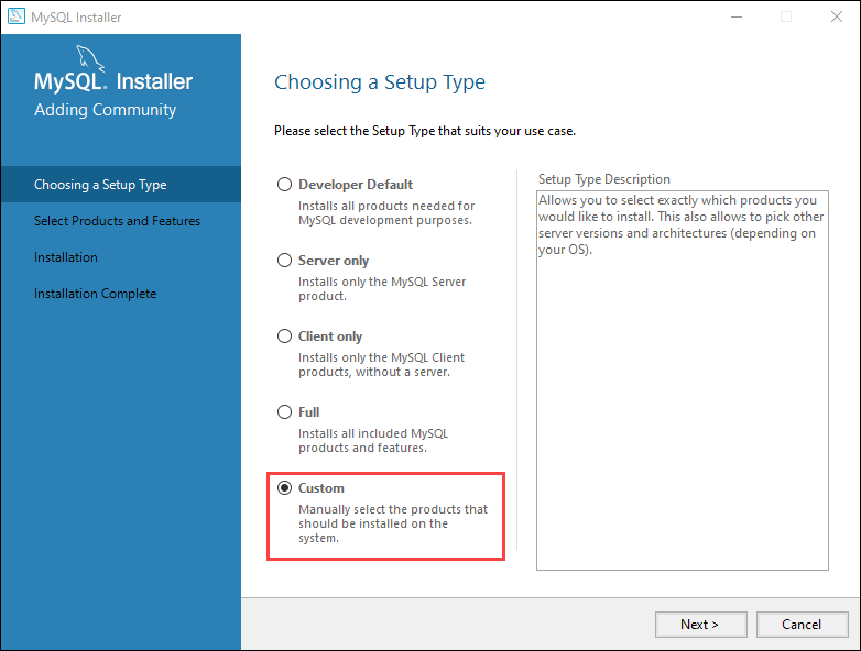

On the Choosing a Setup Type page, select Custom and click Next. While you can select one of the other options, at minimum you'll want to install both the server (the actual database) and MySQL Workbench (an application that allows you to quickly and easily interact with the database, without using a command-line client). Any other items beyond these two are generally unnecessary in most environments.
If you want to learn more, MySQL does have some additional information on their documentation if you're curious about the other options: MySQL Docs. This example will continue with a Custom installation.On the Select Products and Features page, scroll down to choose MySQL Server 8.0. Click the right arrow to move it to the "Products/Features To Be Installed" column.
