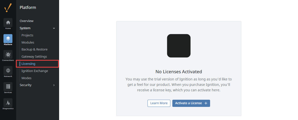

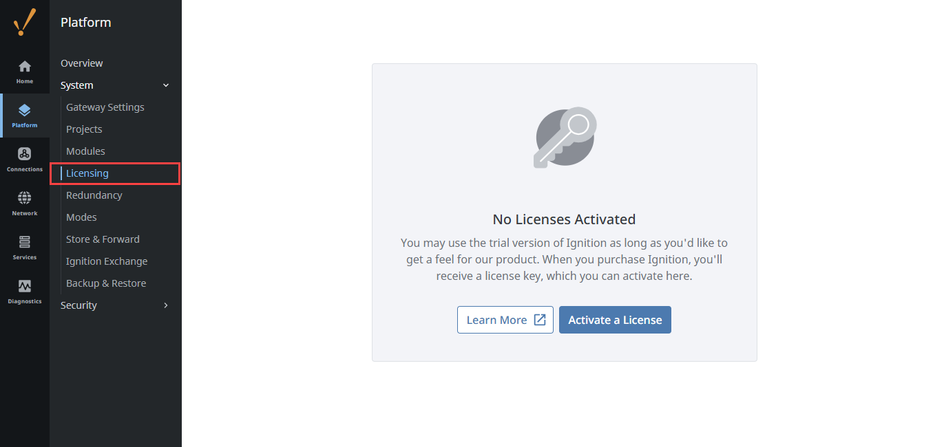

  1. On your agent Gateway, select Platform > System > Licensing. You can see that no license is currently installed.

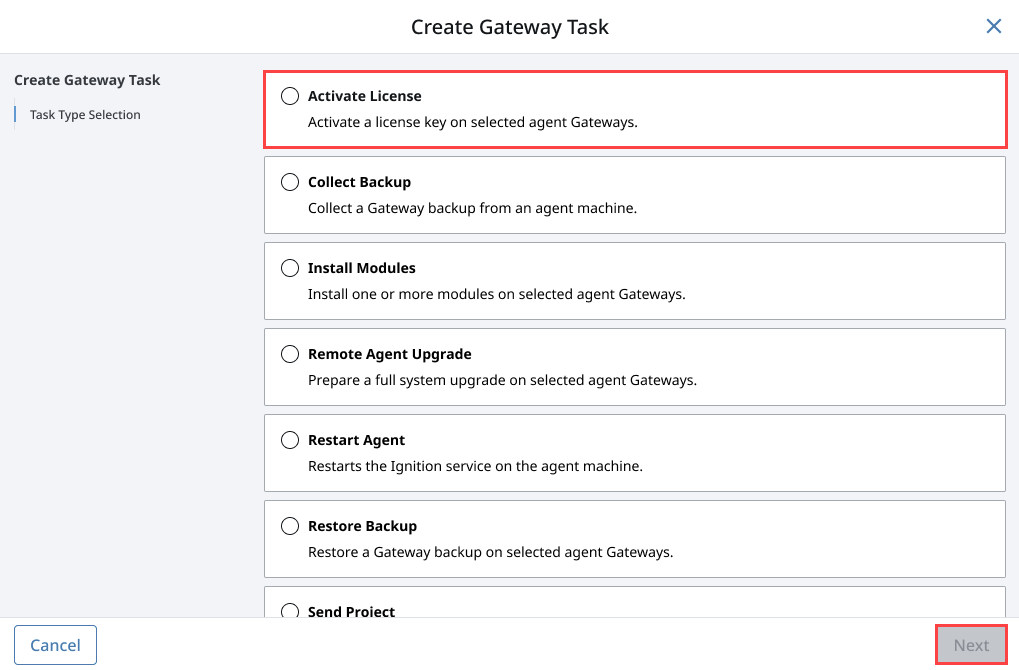

  2. Activating a license on an agent must be done from the controller. On your controller Gateway, select Network > Enterprise > Agent Tasks.
  3. Click Create Agent Task +.
  4. Select Activate License and click Next. The Create Agent Task form will walk you through each step of the license activation process.

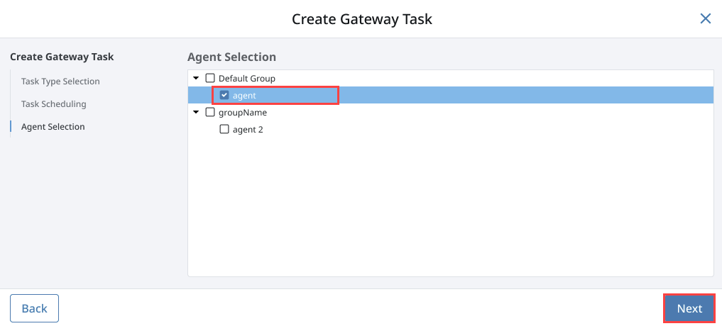

  6. Select the agent you want to activate the license on and click Next.

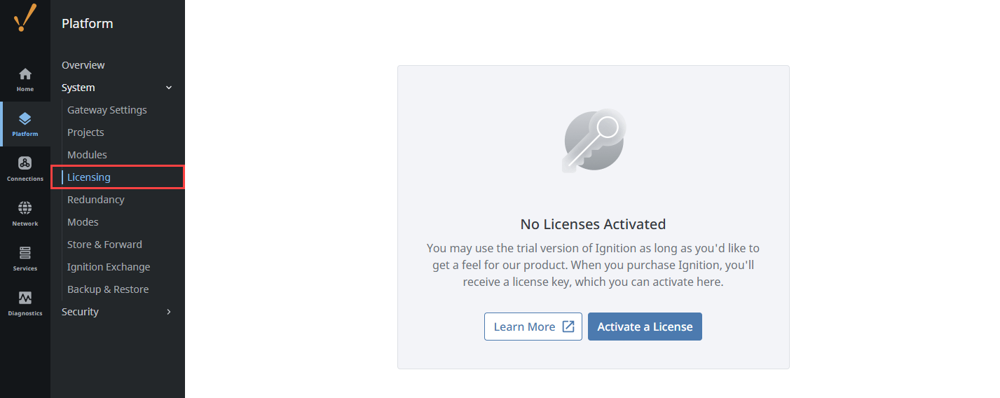

  9. Go to the agent Gateway to validate that the agent license was activated. You may see an Access Denied message. This is because the page was automatically updated. Simply refresh the page.

  10. Click on Platform > System > Licensing and verify your License Key on the agent. This page shows all the modules on your license as well as the versions they are licensed for.

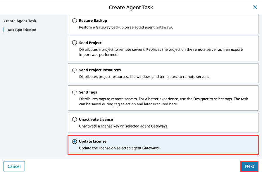

Update a License​
In the event you need to reload or update a license on your agent, go to the controller Gateway.
  1. Navigate to Network > Enterprise > Agent Tasks.
  2. Click Create Agent Task +.
  3. Select Update License and click Next. The Create Agent Task form will guide you through the license update steps.

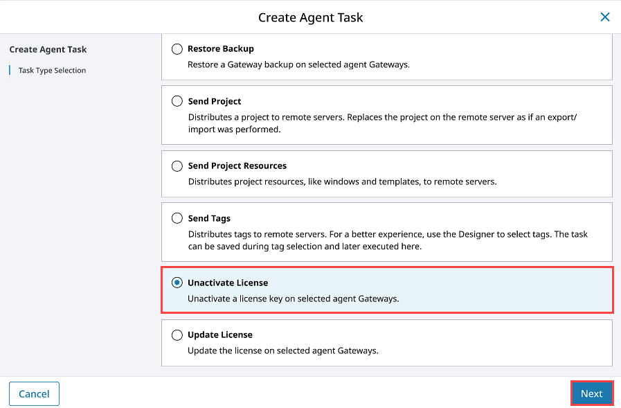

Unactivate a License​
If you need to unactivate a license, go to the controller's Gateway Webpage.
  3. Select Unactivate License and click Next. The Create Agent Task form will guide you through the unactivate license steps.
