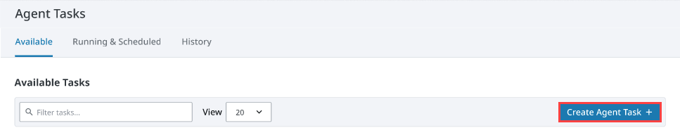

  1. On the controller Gateway, under the Network section of the Gateway webpage, go to Enterprise > Agent Tasks.
  2. Click Create Agent Task.

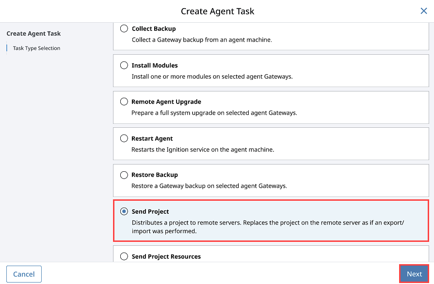

  3. Scroll down and select Send Project. Click Next.

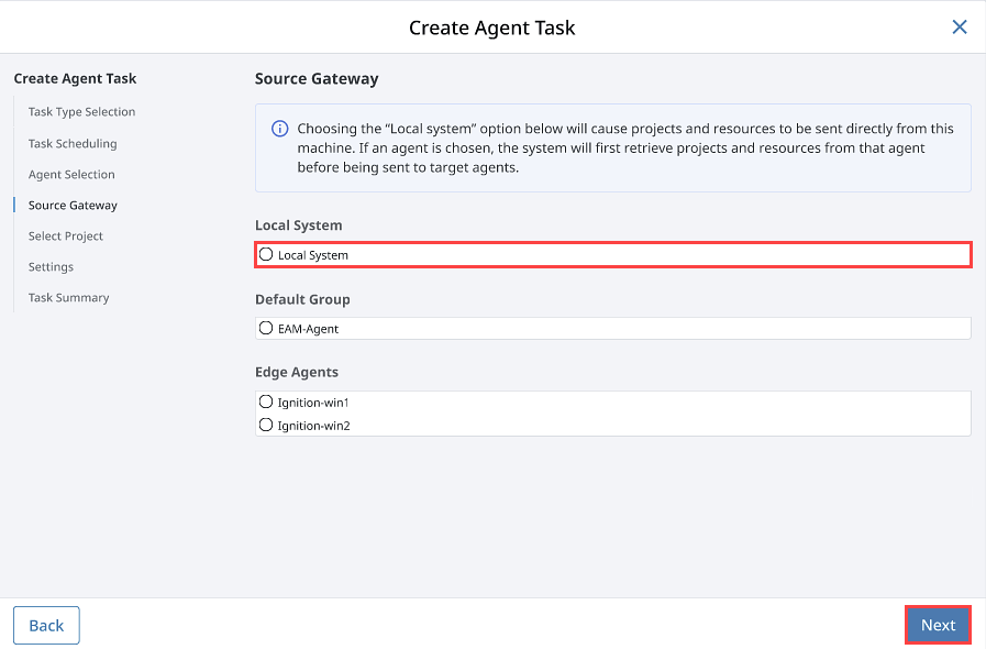

  6. The Create Agent Task form knows your controller and agent configuration. It’s going to prompt you to choose the machine where your project is located. In this example, the project that you want to send is located on the controller or Gateway Source so select Local System and click Next.

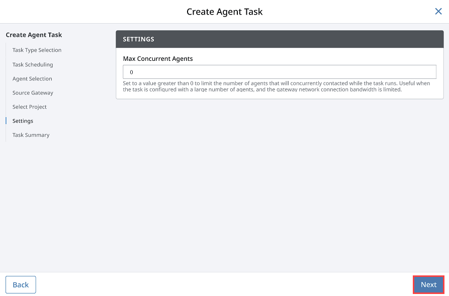

  8. Confirm the Max Concurrent Agents setting, which helps in situations where network connections are weak or bandwidth is limited. For this example, we will leave the value at the default of 0, which disables the setting.

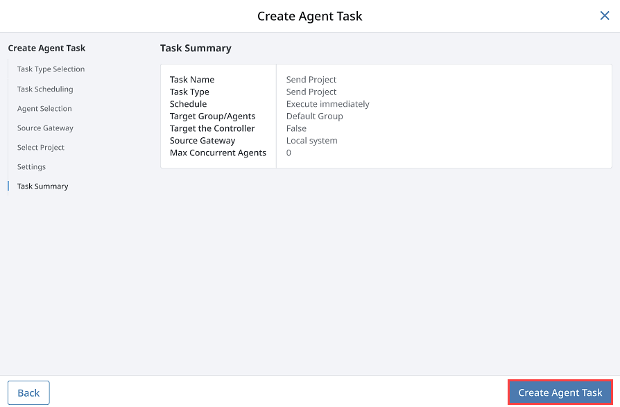

  9. Review your task information and click Create Agent Task.
Your project will be sent from the controller Gateway to the agent Gateway, the screen will refresh, and a message will pop up stating that your Send Project task was successful. To verify that your project was sent, go to your agent Gateway, click Platform, and select System > Projects.

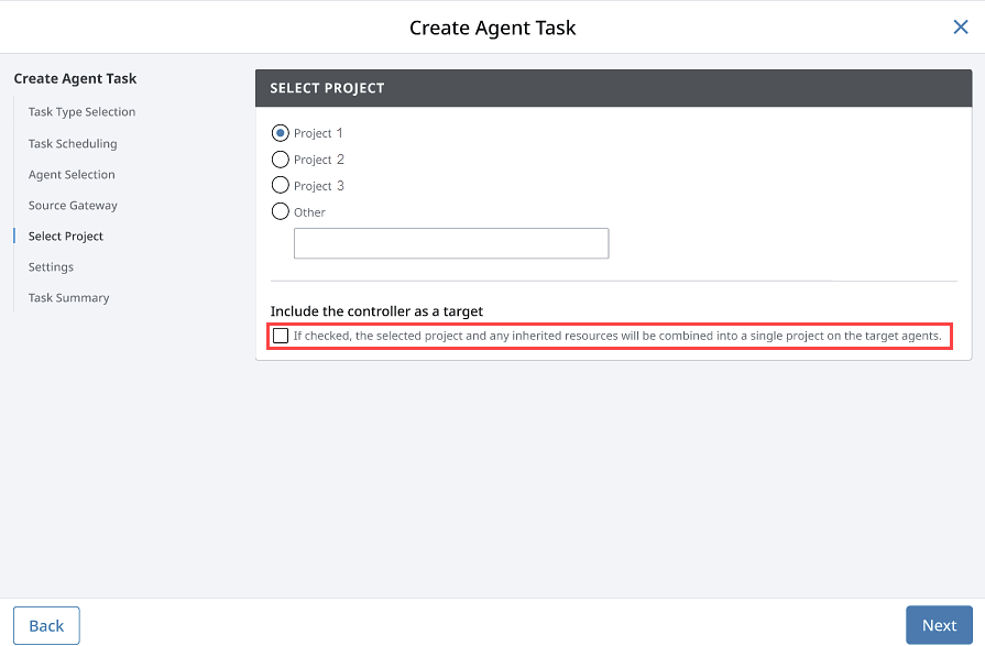

Inherited Resources​
An option for the Send Project task to include inherited resources is also available when sending a project from the controller to an agent. If checked, the selected project and any inherited resources will be combined into a single project on the target agents.
A checkbox was added to the Agent Tasks, as shown in the image below, to include inherited project resources. The default is false.

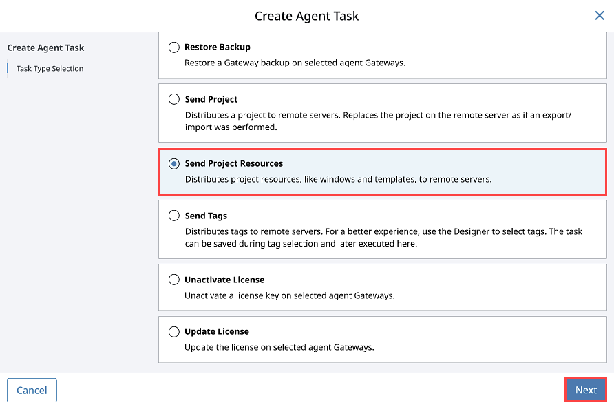

  1. Click Create Agent Task.
  2. Select Send Project Resources and click Next.
