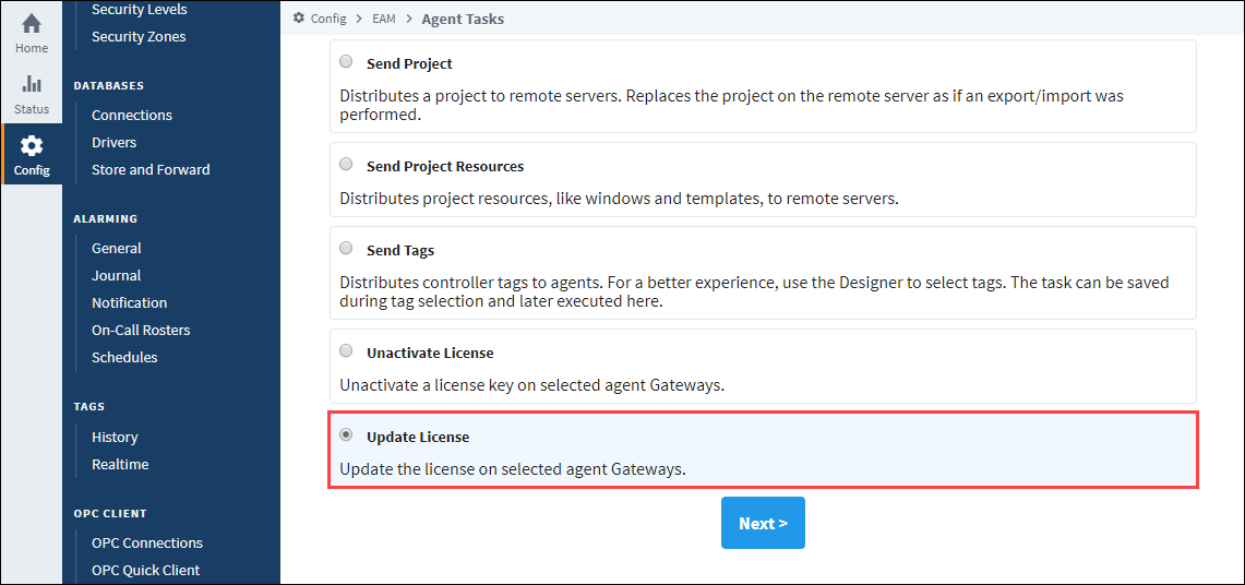

Update a License​
In the event you need to reload or update a license on your Agent, go to the Controller
  1. Navigate to Config > Enterprise Administration > Agent Tasks.
  2. Click the Create new Gateway Task link.
  3. Select Update License and click Next. The EAM Wizard will guide you through the license update steps.
Unactivate a License​
If you need to unactivate a license, go to the Controller's Gateway Webpage.
  2. Click Create new Gateway Task.
  3. Select Unactivate License and click Next. The EAM Wizard will guide you through the unactivate license steps.
