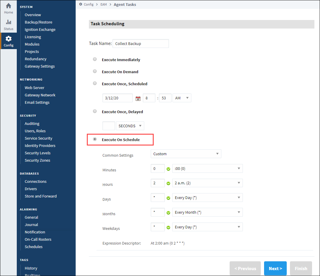

  3. Set the task name to a descriptive name of your choice. The following scheduling options are available:
    • Execute Immediately: The task will begin execution as soon as you complete the wizard.
    • Execute On Demand: The task will not be scheduled, but is available for immediate execution at any time after you complete the wizard.
    • Execute Once, Scheduled: The task will run once at the date and time that you specify.
    • Execute Once, Delayed: The task will run once after the specified number of seconds, minutes, hours, or days.
    • Execute On Schedule: This type of schedule uses UNIX cron type scheduling, where a pattern of 5 numbers determines the recurring schedule. For example, “30 3 * * *” means run a task every day at exactly 3:30 AM. Use the dropdowns next to the pattern textboxes to build out the pattern for the schedule.
    After you determined your task schedule, click Next.
