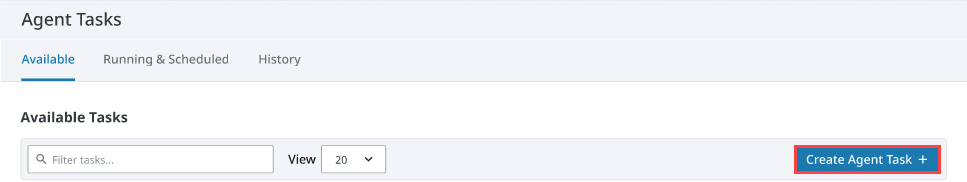

Agent Gateway Tasks are useful for applying an action to many agent Gateways at once. To create a new task, or to view running tasks, navigate to Network > Enterprise > Agent Tasks. The Agent Tasks page will display available tasks, scheduled tasks, currently executing tasks, and task history.
  1. To create a new task, click Create Agent Task. The Create Agent Task form will guide you through each step of a Gateway task.

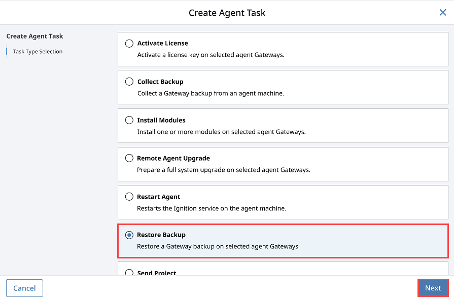

  2. Select the type of task you wish to execute. After you selected a type of task, click Next.
