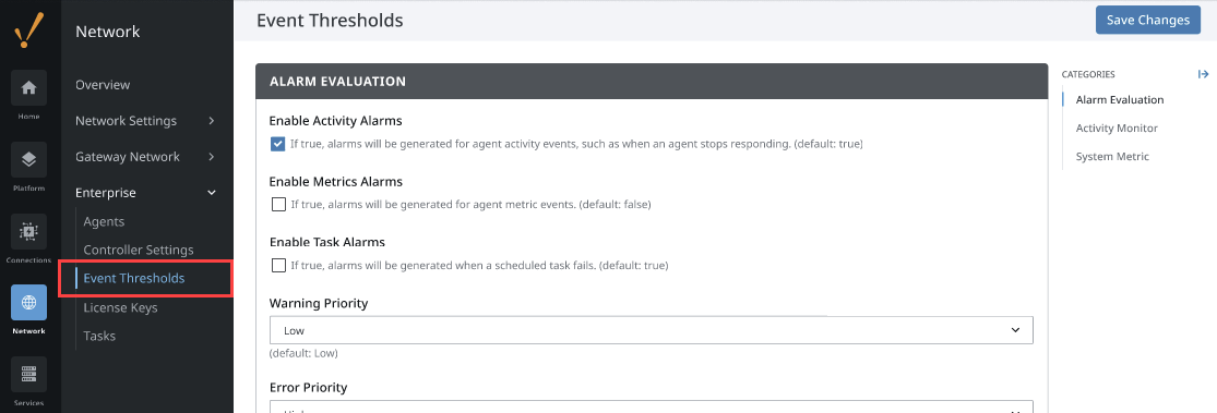

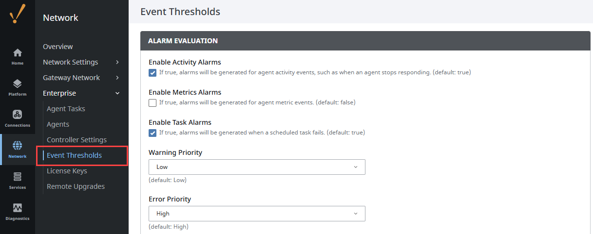

General Settings
To view the event thresholds, go to the Network page on the Gateway and select Enterprise > Event Thresholds.
Alarm Evaluation
This section is for activity and metric events, you can configure alarms to trigger when an event is reported at the warning or error level. You can also set the alarm pipeline that will process the generated alarms. These alarms are triggered by value changes, with the alarm being cleared as soon as it becomes active.
