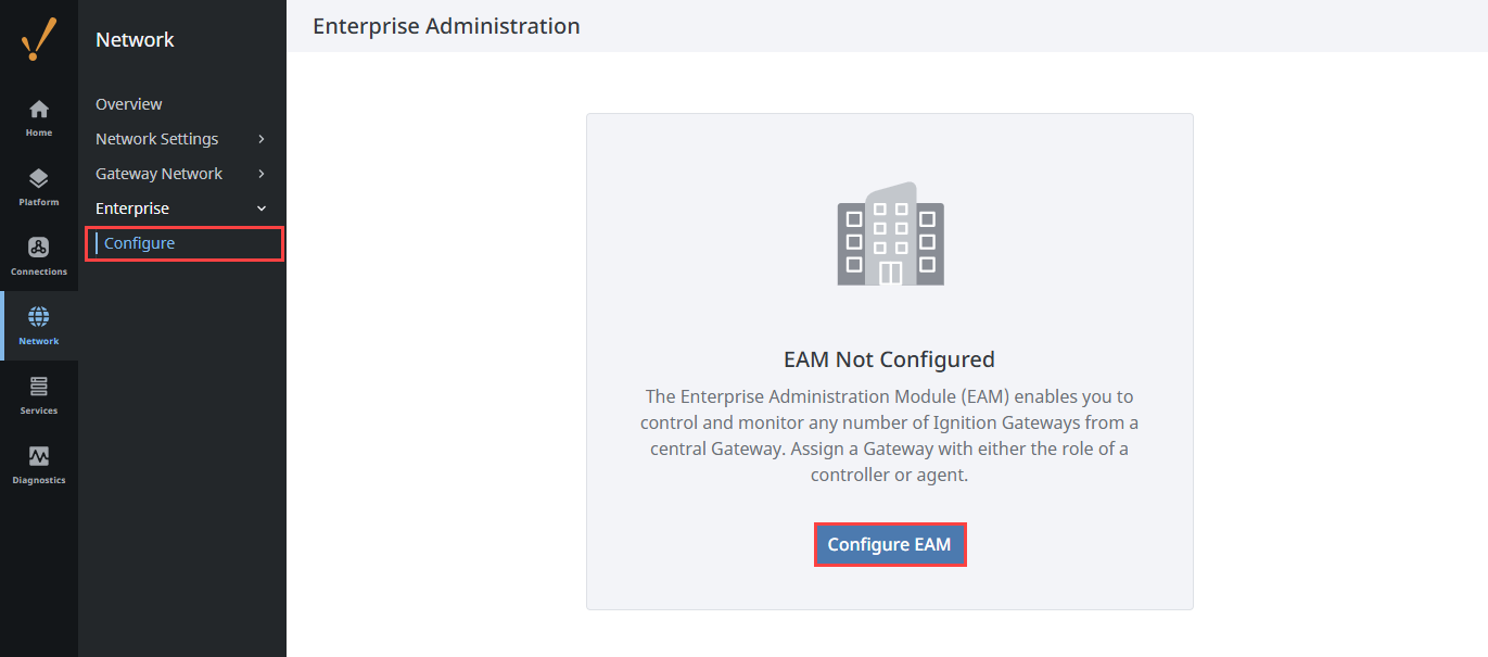

  1. Navigate to Network > Enterprise > Configure and select Configure EAM. The EAM Setup Wizard will appear.

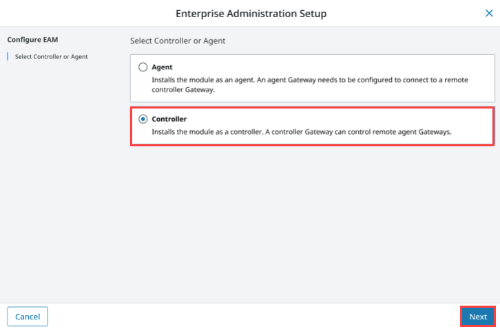

  2. Since you are installing the controller, select Controller on this screen. Click Next.

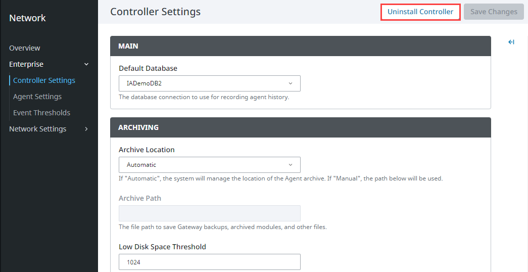

  5. Once you set up your controller, the configuration options disappear and the menu will now list more Enterprise options.

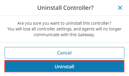

Remove a Controller​

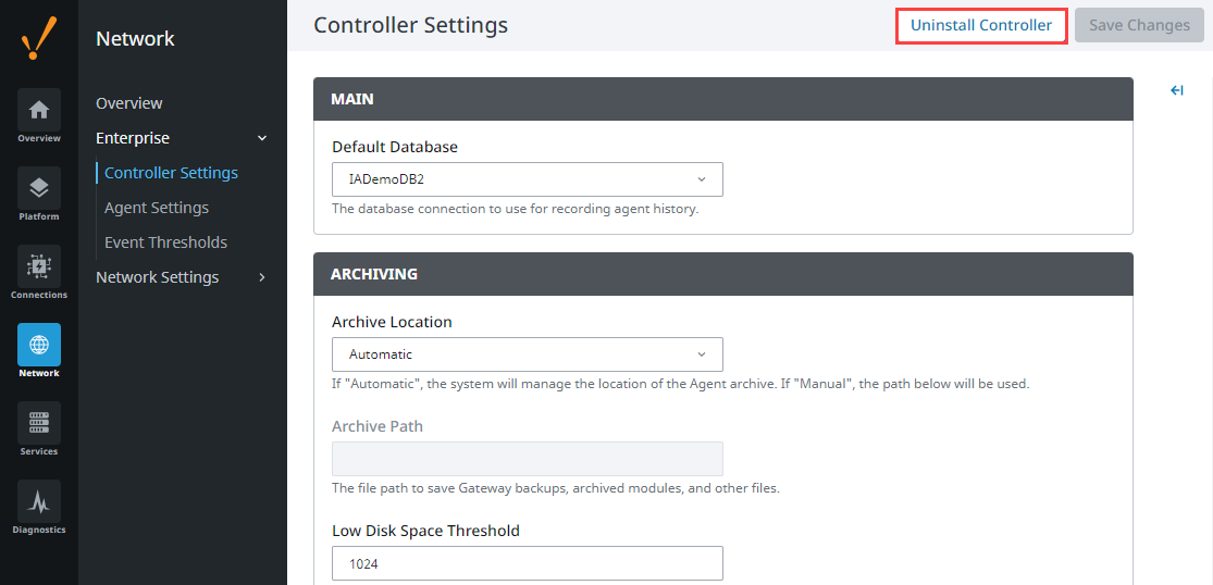

  1. To remove a controller from the Gateway, go to the Network section.
  2. Select Enterprise > Controller Settings.
  3. Click Uninstall Controller in the upper right corner.
  4. A confirmation window will appear. Click Uninstall to complete uninstalling the controller.

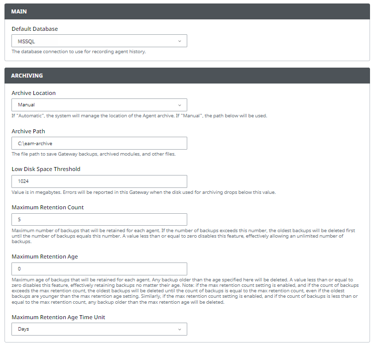

Controller Settings​
The table below lists the main properties found in the Controller Settings:
SettingDescription
Default DatabaseThe database connection to use for recording agent history.
The table below lists the archiving properties found in the Controller Settings:
SettingDescription
Archive LocationChoose between Automatic and Manual. If Automatic, the system will manage the location of the agent archive. If Manual, the path from the  Archive Path setting will be used.
Archive PathThe file path to save Gateway backups, archived modules, and other files. Disabled if the Archive Location setting is set to Automatic.
Low Disk Space ThresholdValue is in megabytes. Default value is 1024. Errors will be reported in this Gateway when the disk used for archiving drops below this value.
Maximum Retention CountMaximum number of backups that will be retained. If the number of backups exceeds this number, the oldest backups will be deleted first until the number of backups equals this number. A value less than or equal to zero disables this feature, effective allowing an unlimited number of backups. Default is 5.
Maximum Retention AgeMaximum age of backups that will be retained. Any backup older than the age specified here will be deleted. A value less than or equal to zero disables this feature, effectively retaining backups no matter their age.
Note: If the Maximum Retention Count setting is enabled, and if the count of backups exceeds the max retention count, the oldest backups will be deleted until the count of backups is equal to the max retention count, even if the oldest backups are younger than the Max Retention Age setting. Similarly, if Max Retention Count is enabled, and if the count of backups is less than or equal to the max retention count, any backup older than the max retention age will be deleted.
Maximum Retention Age Time UnitThe time unit to use when specifying the Maximum Retention Age setting. Choose between Days, Weeks, Months, or Years. Default is Days.
