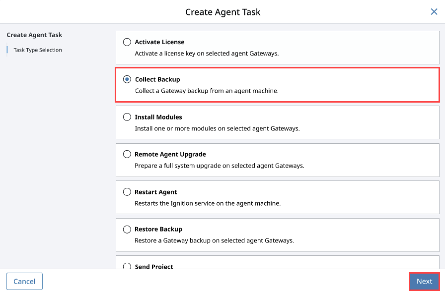

  1. On the controller Gateway, navigate to Network > Enterprise > Agent Tasks
  2. Click Create Agent Task.
  3. Select Collect Backup and click Next. The Create Agent Task form will walk you through each step of the Collect Backup process.

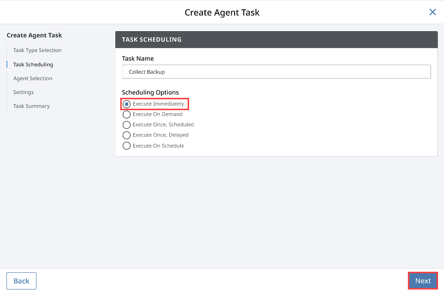

  4. There are several different task scheduling options available. For this collect backup example, choose to Execute Immediately and click Next. If you need more information on other scheduling options, refer to Task Scheduling.

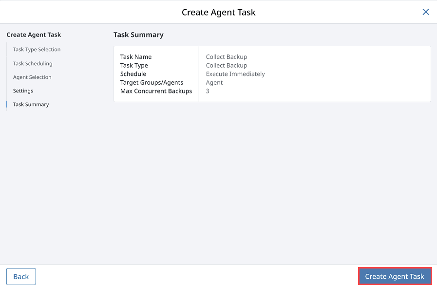

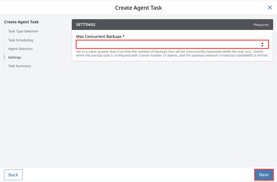

  6. Set the number of Max Concurrent Backups you want. There is no limit by default, though setting a higher value may help if there is a large number of agents, or if network bandwidth is limited. Click Next.
  7. Review the Task Summary information and click Create Agent Task.
Once the Collect Backup task is complete, a success message will be displayed. You can even check the Task History which will provide a list of all previously executed tasks. Your new Gateway backup will be stored wherever your controller settings are pointing to when the controller was initially created.

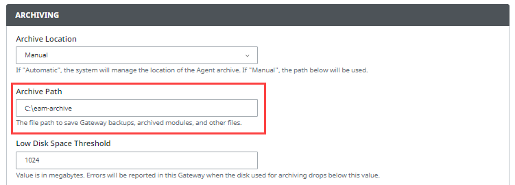

To check, go to the controller Gateway, and navigate to Network > Enterprise > Controller Settings. You can have your Archive Path set to Automatic or Manual. If you have it set to Automatic, you can find your backups inside the directory for Ignition, otherwise, it will be the folder location that is specified in the Controller Settings. To learn more about controller settings, refer to Creating a Controller.

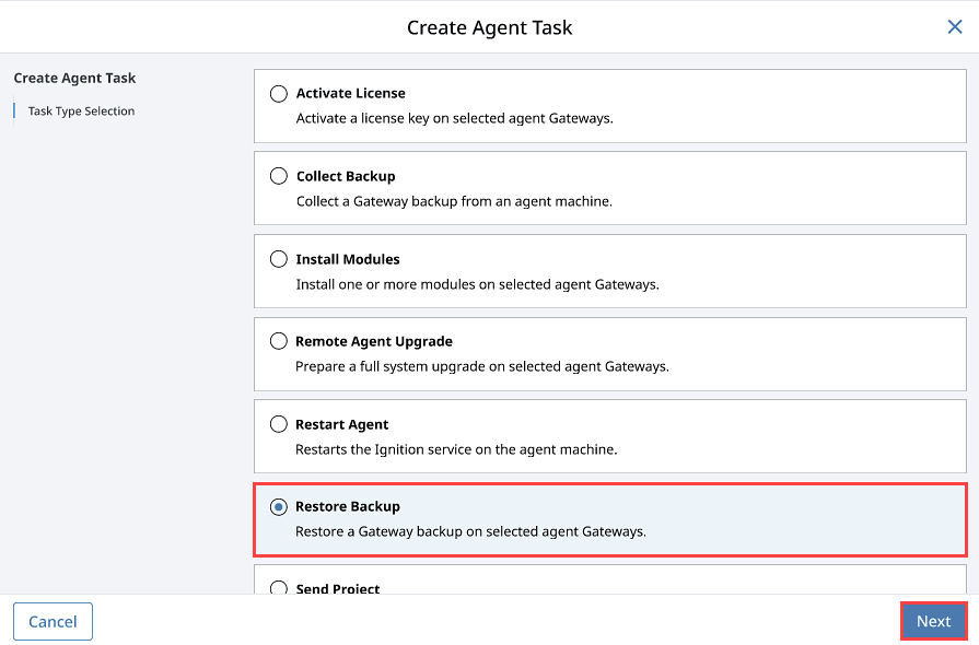

  1. On the controller Gateway, navigate to Network > Enterprise > Tasks.
  3. Select Restore Backup and click Next.
  4. Schedule the Restore Backup task from any of the listed scheduling options. This example uses Execute Immediately. Click Next.
  5. Select the Agent. Click Next.

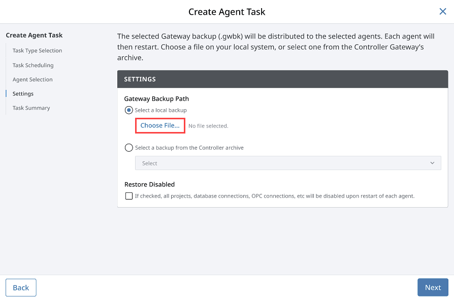

  6. If your Archive Path was set to Manual when you created your controller, select Choose File and navigate to the folder on your computer to locate the Gateway Backup file. If you are unsure about your Archive Path, refer to your Controller Settings.
    note
    You can also restore a Gateway backup from the controller's archive by clicking the Select a backup from the Controller archive and selecting the .gwbk file you want to restore.
  7. Once you choose the file, click Open. Click Next on the Restore Backup task.

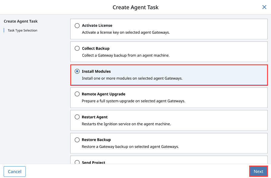

Install Modules​
This task allows you to install one or more modules on an agent. You may pass in the modules to install while creating the task, or choose from the archived modules. Modules are archived in the Collect Backup task.
As an example, suppose you accidentally uninstalled the Alarm Notification and OPC UA modules from your agent. Let's go ahead and reinstall them using the Install Modules task.
  1. Go to the controller Gateway, and navigate to Network > Enterprise > Agent Tasks.
  3. Select Install Modules and click Next.
  4. Schedule the Install Modules task using one of the listed scheduling options. This example uses Execute Immediately. Click Next.
  5. Select the Agent and click Next.
  6. On the Select Modules form, click Add for the Alarm Notification and OPC UA modules. You will notice, that once you select a module, it shows up in the Selected Files list. You can choose as many modules as you need, and when you're finished, click Next.
  7. Accept and Acknowledge the certificate and license terms by clicking Next as needed.
  8. Review the Task Summary and click Create Agent Task. Once the Install Module task completes, you will get a successful message from the Gateway.

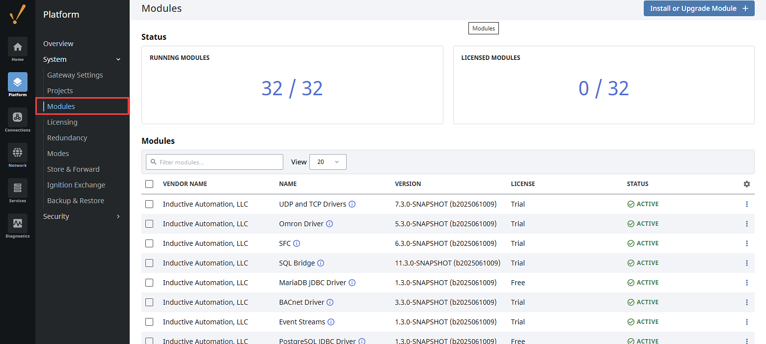

  9. Go back to your Agent, and navigate to Platform > System > Modules to verify that both the Alarm Notification and OPC UA modules were installed and are running successfully.

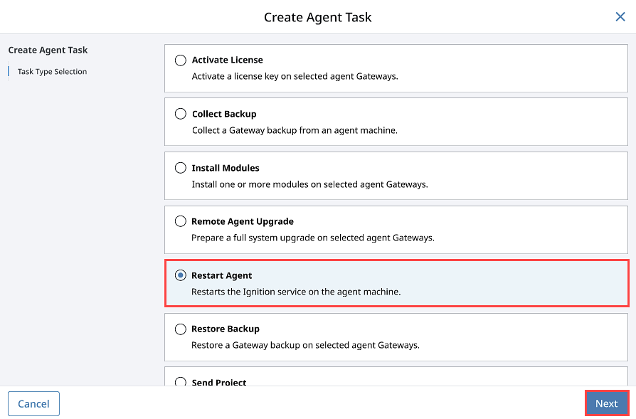

Restart Agent​
On the controller Gateway, let's create another Gateway Task to restart the agent. This task will stop the Ignition service on the agent and start it back up again.
  3. Select the Restart Agent and click Next.
  4. Schedule the Restart Agent task to Execute Immediately and click Next.
  5. Select the agent and click Next.
  6. Review the Task Summary and click Create Agent Task. Once the Restart Agent task completes, you will receive a successful message from the Gateway Task.
