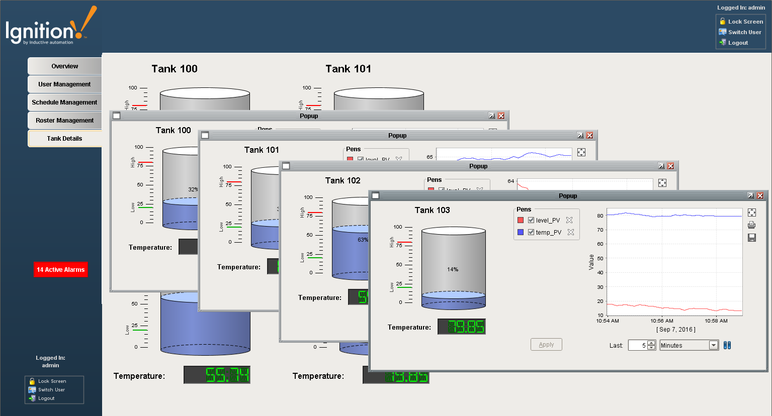

In this example, suppose you have four tanks in your client. If you click on any one of the four tanks, you will get a popup window that gives you some additional information about that tank.
If you click on another tank, for example Tank 101, the popup window switches to Tank 101, but there are still three windows open: Navigation window, Main window, and a Popup window (use the Windows Menubar at the top of the screen to view all open windows in the Client). What happens is when clicking on a different tank reopens the popup window and passes in new parameters. This is the default behavior because the number of open windows you can have at one time is limited in the client. You can change this behavior and have multiple instances of the same window open at once using a script.

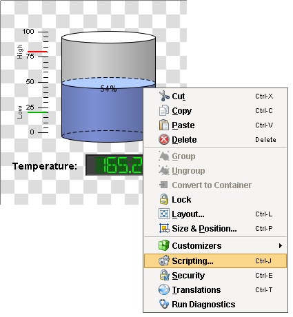

  1. In Designer, go to your Tank template. Right click on your Template and scroll down to Scripting.
    Opening Multiple Instances of a Popup Window Step 1

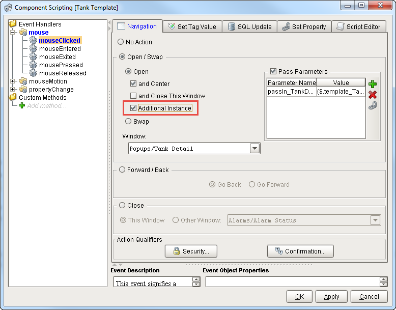

  2. You'll notice that the Navigation tab settings are set to Open/Swap and are passing some Tank parameters over to the popup window. Check the Additional Instance box to make the script open up additional instances of your popup windows. When you click on the Additional Instance box, Ignition automatically enables the navigation script builder. It also tells the script instead of using the same popup window, to open up a new instance if there is another popup window already open instead of switching it out (to view the script, click on the Script Editor tab. You'll notice the system.nav.openWindowInstance function is used). Click OK.
    Opening Multiple Instances of a Popup Window Step 2

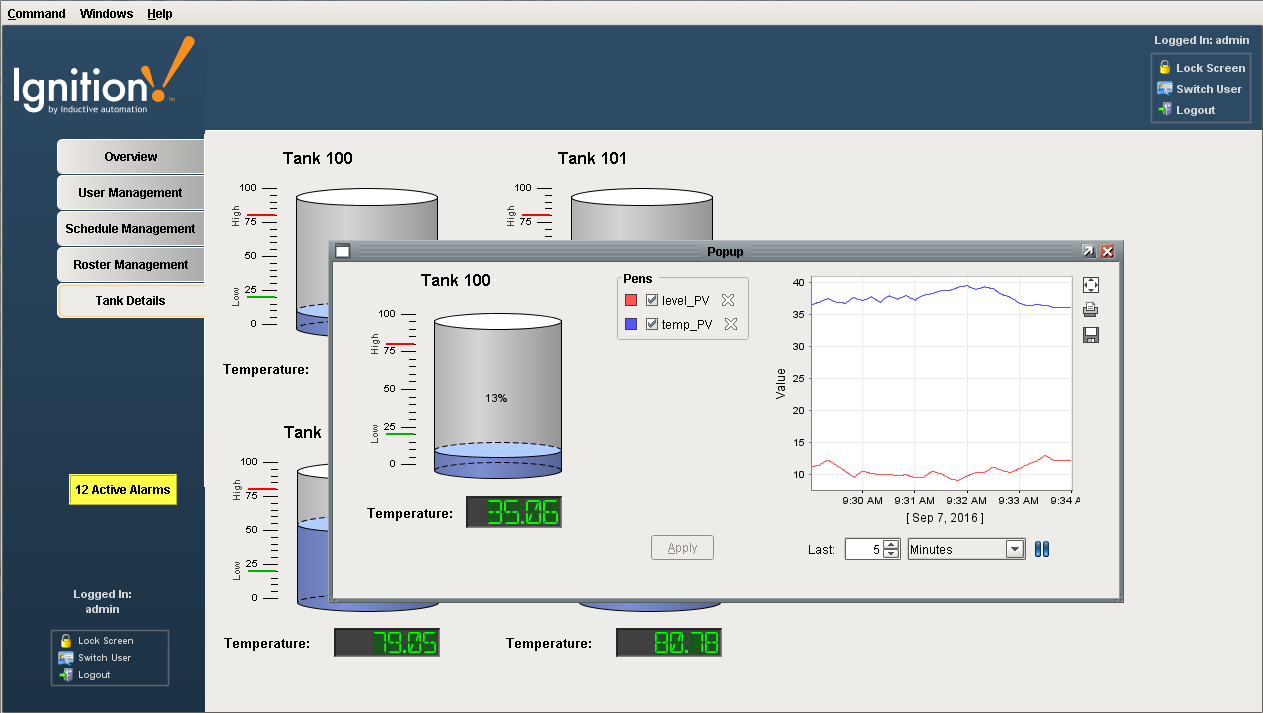

  4. Open your Client, or if you already have it open, update the client by clicking the yellow bar. Click on each of your Tanks, and you'll see multiple instances of the same popup for each different tank.
Opening Multiple Instances of a Popup Window Step 4
