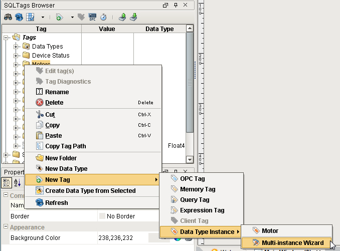

  2. Right-click on the Motors folder, and select New Tag > Data Type Instance > Multi-Instance Wizard.

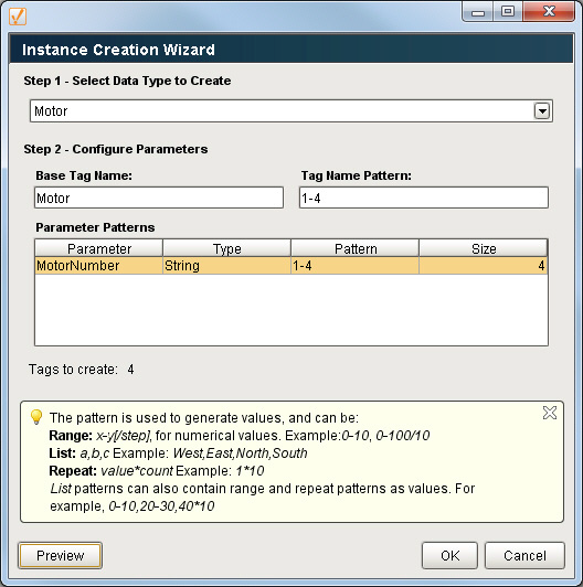

  3. The Instance Creation Wizard is displayed. From the Step 1 - Select Data Type to Create, select Motor from the dropdown list.
  4. Configure the following parameters:
    • Base Tag Name: Motor
    • Tag Name Pattern: 1-4 (This creates four Tags: Motor 1, Motor 2, Motor 3, Motor 4.)
    • Parameter: MotorNumber (This is used to reference specific Tags in the PLC.)
    • Pattern: 1-4 (This assign Motor 1 Tag a parameter of 1, Motor 2 a parameter of 2, and so on.)

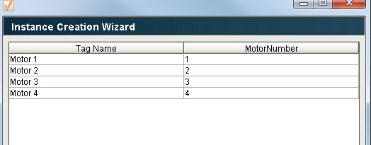

  5. Click Preview to see how Ignition creates the Tag name and the Parameter Value.
  6. Click the Back button to exit the Preview screen to go back to the Instance Creation Wizard screen.

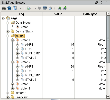

    Click OK to create your instances. Now, expand all your Motor Tags to see if all the members of the UDT were created and are running.

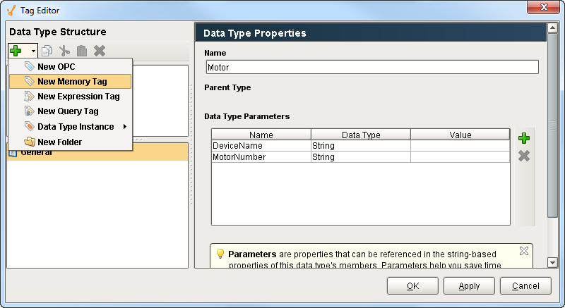

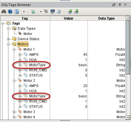

  1. To make a change to your Motor UDT, go to the Tag Browser and double click on Motor. This example adds a new Memory Tag.
  2. The Tag Editor will open. Click on the green + button on the top-left of window, and select New Memory Tag.

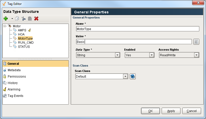

  3. Configure the following properties:
    • Name: MotorType
    • Data Type: String
    • Value: Basic
Click OK.
  1. Now, each instance automatically gets the new Memory Tag. Expand each of your Motor Tags to see the new MotorType.
You can make rapid work of making changes to instances using a UDT.
