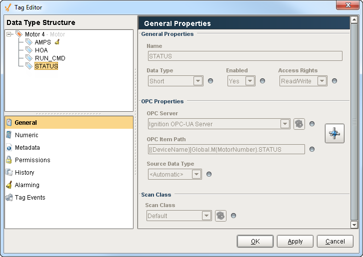

  1. From the Tag Browser, you would go to Tags > Data Types, right-click on Motor 4, then select Edit tag(s).
    The Tag Editor window will open.
  2. Under Data Type Structure, select the STATUS Tag.
    You can see that none of the fields are enabled so you can't make any changes to them.

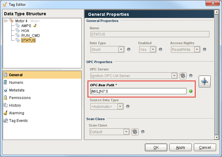

  3. Look for the circle to the right of the OPC Item Path box and click it so you can highlight this box.
    The circle changes its color to green and the field becomes enabled allowing you to override the OPC Item Path inherited from the parent.
  4. Edit the OPC Item Path, and click OK.

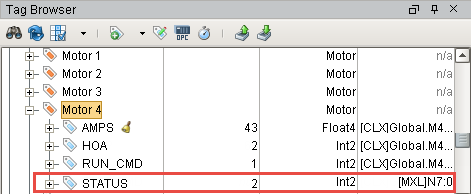

  5. Go to the Tag Browser, click on the Column selection icon on the toolbar, and select the box for OPC Item Path.
    See your changes in the column that displays the value of the OPC Item Path.
