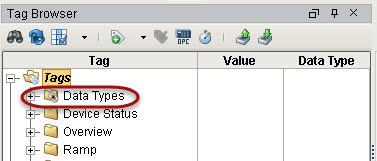

The Data Type Folder
When creating a new data type, the new definition is always placed in the Data Types folder, regardless of which folder was selected before creating the new definition.
Additionally, the Data Types Folder in the Tag Browser can only ever contain UDT definitions, and UDT definitions can only ever exist in the Data Types folder.

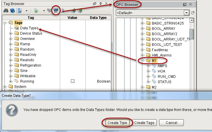

  1. From Tags Browser, click the OPC Browse icon.
  2. Under the CLX folder, go to the Global folder and find the M1 folder.
    M1 represents a motor which has four Tags:
    • AMPS
    • HOA
    • RUN_CMD
    • STATUS
  3. Drag the M1 folder to the Data Types folder in Tags Browser.
    A window prompts you asking if you want to create a type or Tags. Click on Create Type.

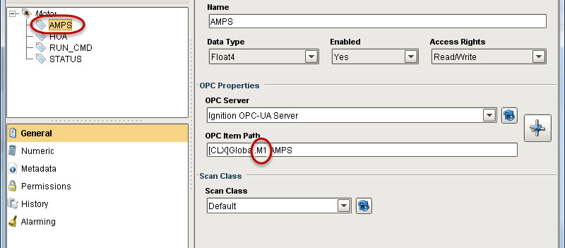

  6. Right now, each Tag is pointing to a specific address in the PLC, select the AMPS Tag to see that it is pointing to M1 in the PLC.
    Because we are creating a UDT, we don't want to point to one specific set of Tags. We want each instance of the UDT to reference a different set of Tags. To do that, we need to add a parameter to the UDT. Parameters are custom properties on data types. You can use the parameters inside the type or instance definition to create parameterized data templates.

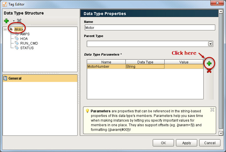

  7. In the Tag Editor, select the Motor data type and add a new parameter by clicking the green + button and setting the following:
    • Name: MotorNumber
    • Data Type: String
    Click OK.

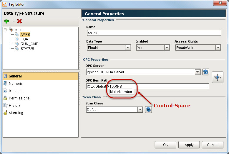

  8. Now for each Tag, we can substitute the motor number with the MotorNumber parameter.
    Open the Tag Editor again, select the AMPS Tag. In the OPC Item Path, put your cursor at the end of M1 and press Ctrl-Space (or the Down arrow key) to bring up the list of parameters, click MotorNumber to add a reference {MotorNumber} into the OPC Item path. Don't forget to delete the '1' from M1 before moving to the next Tag.
  9. Repeat Step 8 for the HOA, RUN_CMD, and STATUS Tags.
    The OPC Item Path will then show the MotorNumber parameter for each of the Tags.

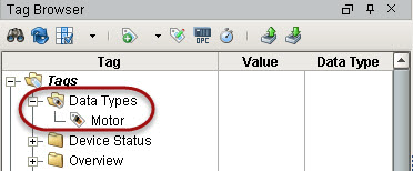

  10. You will then see the Motor UDT in the Data Types folder.

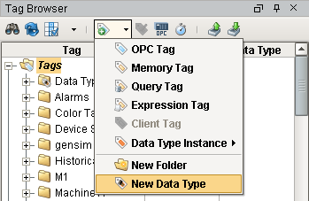

To Create a New Data Type Manually​
When creating a new data type manually, you have to specify the Name of the data type, parameters, and members or Tags that are going to be part of the structure of your new data type.
  1. Select the Tags folder in the Tag Browser.
  2. Click the Tag icon on the Tag Browser toolbar. The Tag creation menu will open.
  3. Select New Data Type from the menu. The Tag Editor window will open.
    When editing complex Tags, the Tag Editor window appears a bit differently. The member tree structure is presented in the upper left. By selecting a member, the Tag property categories are displayed below the member area, and the editor for the selected category appears to the right.

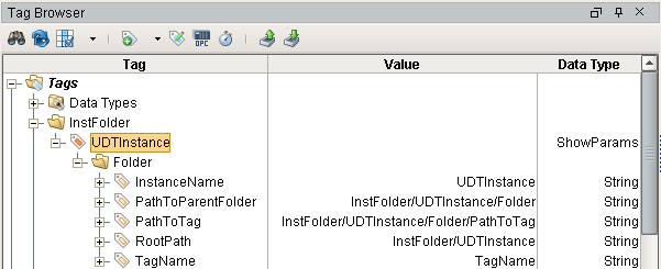

Pre-Defined Parameters​
UDTs have a few parameters already defined to make things easier for you. They give you access to the name and various paths associated with a UDT member Tag. These parameters can be accessed from anywhere in a Tag that a normal parameter can be used. Each of these parameters uses that Tag it is in as a starting point for it's path.
Parameter NameDescription
{InstanceName}The name of the UDT Instance that this Tag is inside.
{PathToParentFolder}The full path to the folder that this Tag is in.
{PathToTag}The full path to the Tag using this parameter.
{TagName}The name of the Tag that is using this parameter.
