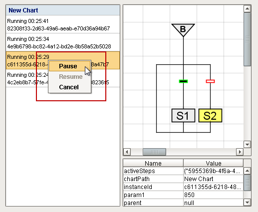

State Changes - SFC Monitor Component​
Changing the state of a Chart can easily be accomplished without scripting from the SFC Monitor component. From the Client you can simply right-click on a running chart, and click the state you wish the Chart to transition to.
Note that the Chart Lifecycle is still in effect, so only charts in a Paused state may be resumed.
