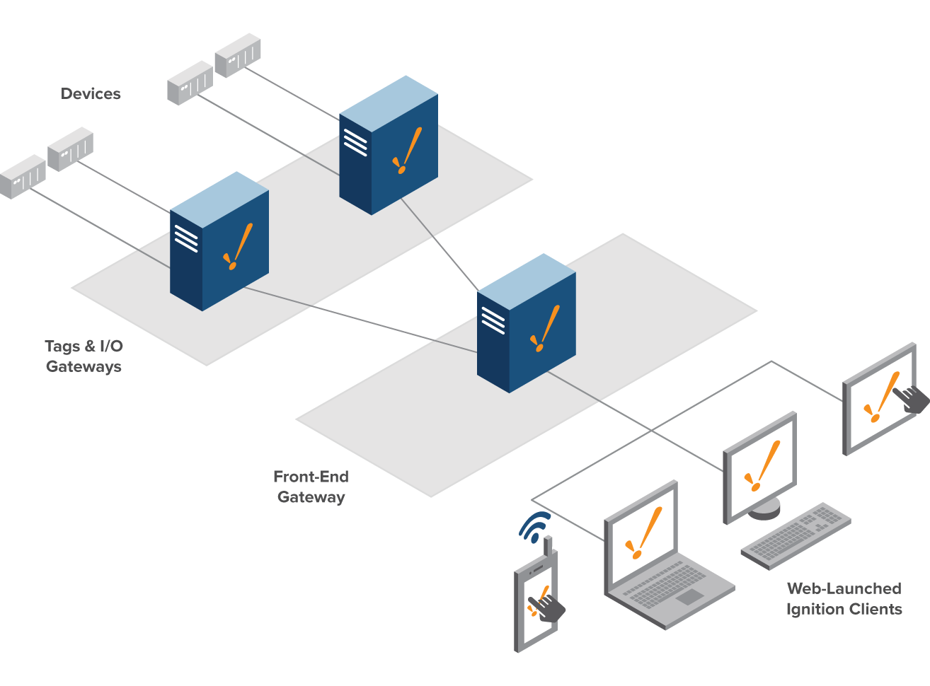

In larger systems, it is often easier to have multiple Ignition installations to help split the load between the front-end tasks and the back-end tasks. This is perfect for single large systems that aren't split up into different sites. In those cases, the Hub and Spoke Architecture is usually a better fit.
In the Scale Out Architecture, we have at least one Gateway that handles back-end communications. The back-end Gateway deals with all PLC and device communications. The front-end Gateway handles all of the Clients, serving up the data pulled from the back-end Gateway. This is made possible through the Gateway Network, connecting Gateways to each other, and allowing Tags to be shared through remote Tag providers.
Scale Out Architecture Diagram

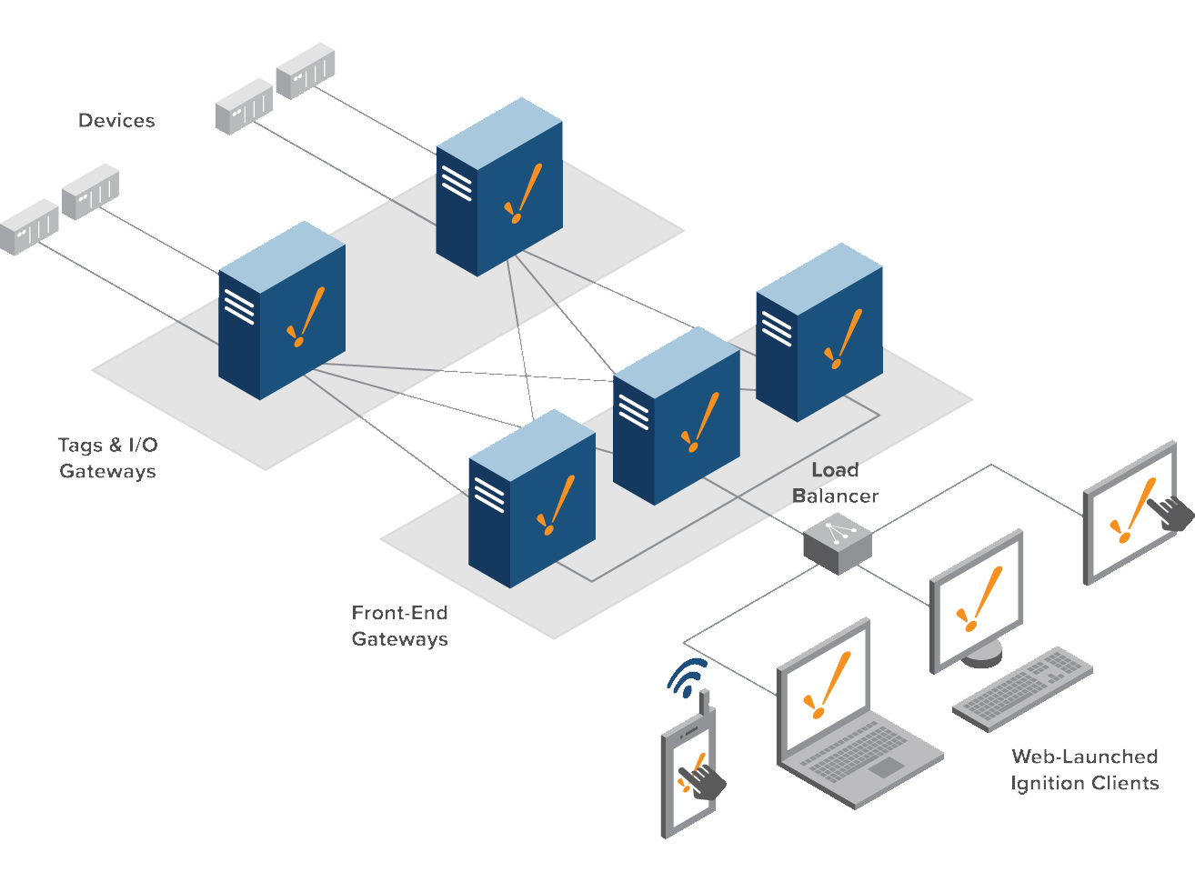

Load Balancing​
The best thing about the Scale Out Architecture is that it is easy to scale up Ignition as your system grows. In the image below, we added more front-end Gateways to help handle an increase in clients, and a Load Balancer to automatically distribute the clients between them.
Scale Out Architecture with Load Balancer

Gateway Types​
When utilizing Scale Out, an Ignition Gateway is given focus due to its placement. There are two possible types:
  • Tags & I/O: Also known as a Back-End Gateway, is responsible for communicating with the PLCs, and executing Tags. They share their local Tags with the Front-End Gateways via a Remote Tag Provider, and are generally responsible for recording history. Additionally, alarms can be added to Tags locally, and exposed elsewhere in the system.
  • Front-End Gateway: Sometimes called a Visualization Gateway, this Gateway is responsible for hosting the clients, allowing the Back-End Gateways to focus solely on PLC communication and history.
