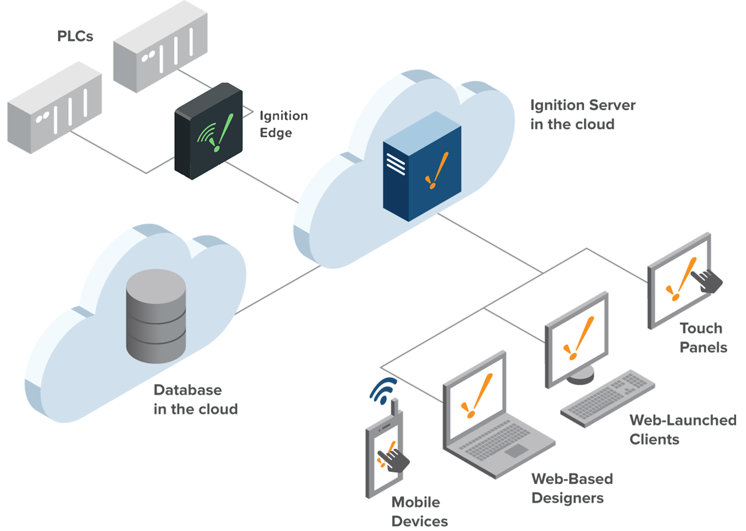

Architecture Example
In this example, we see the Standard Architecture, but with the Ignition Server and Database both running on cloud servers. Note, that the Database and Ignition are on different cloud servers. This is because cloud service providers generally have specialized services that are designed explicitly for hosting SQL databases, as well as more general purpose services such as running Ignition. An installation of Ignition Edge is placed local to the PLCs, and is responsible for forwarding data to the cloud.
