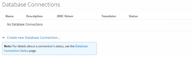

    The Database Connections page will be displayed.
  3. Look for the blue arrow, click on Create new Database Connection....

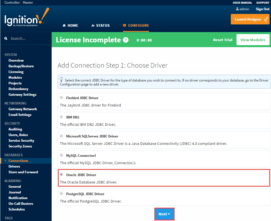

  1. Select the Oracle JDBC Driver and click Next.

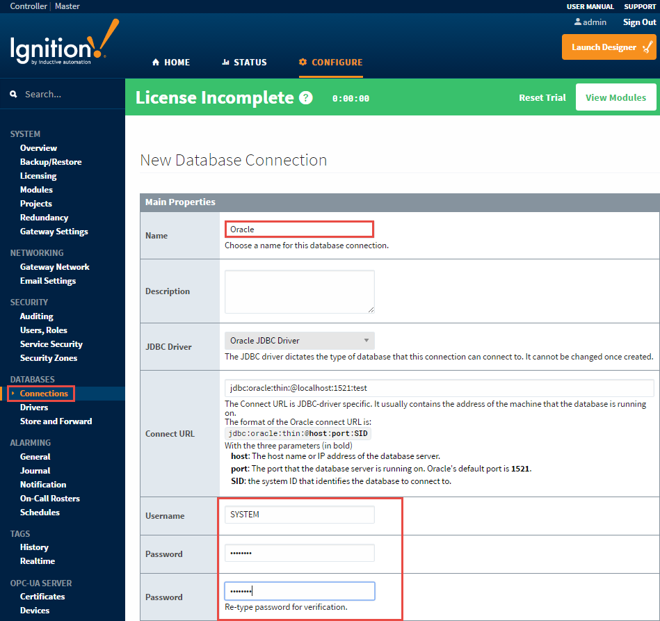

  1. Enter the following information:
    Connect URL: jdbc:oracle:thin:@localhost:1521:XE (XE is the System ID in Oracle)
    username: SYSTEM
    password: oracle (password is what you entered in during the Oracle server installation, in this example, the password is oracle)

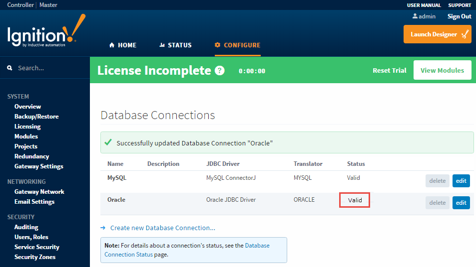

  1. Click Create New Database Connection at the bottom of the form.
    The Database Connections page is displayed showing the Status of your connection as Valid.

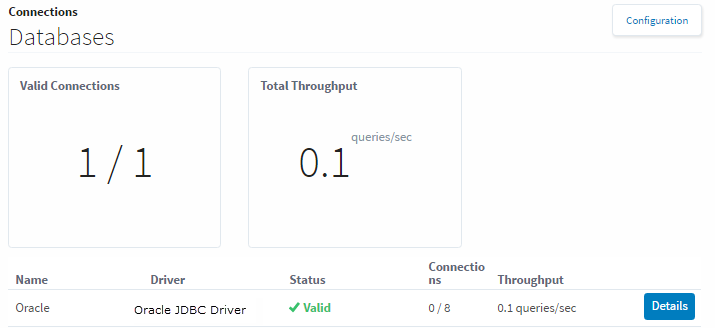

  1. To display the details about the status of your database connection, see the Note on the above window and click on the Database Connection Status link.
