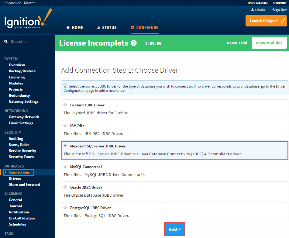

  1. From the Gateway, go to the Configure section.
  2. From the menu on the left, select Databases > Connections.
    The Database Connections page will be displayed.
  3. Look for the orange arrow, click on Create new Database Connection....
  4. Select Microsoft SQLServer JDBC Driver and click Next.
The New Database Connection page will be displayed.

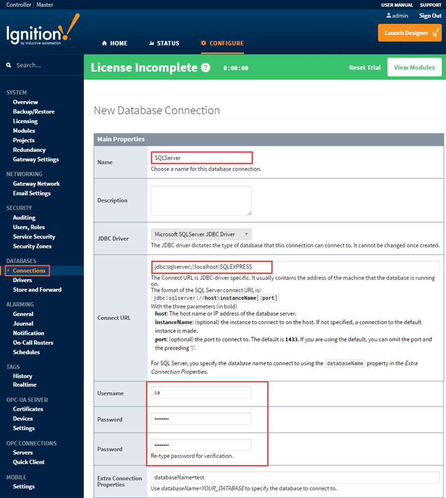

  1. On the New Database Connection page, enter the following information:
    Connect URL: jdbc:sqlserver://localhost\SQLEXPRESS
    username: sa
    password: sqlserver (password is what you entered during the SQL Server installation. For this example, password is sqlserver)
note
We are connecting to the express edition of SQL Server using the default instance name in the Connect URL field. If you have the full SQL Server with default settings, replace SQLEXPRESS with MSSQLSERVER.

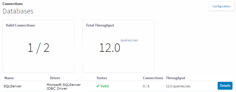

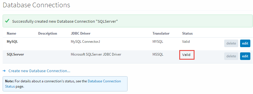

  1. At the bottom of the form, click on Create New Database Connection.
    Your connection is now created and the Database Connections page is displayed showing the Status of your connection as Valid.
  1. To display the details about the status of your database connection, see the Note on the above window and click on the Database Connection Status link.

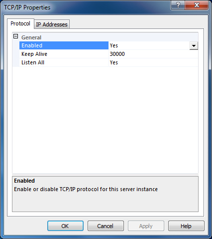

Check 1: Make Sure the Database has TCP/IP is Enabled​
Ignition connects using TCP/IP, therefore make sure your database has TCP/IP enabled.

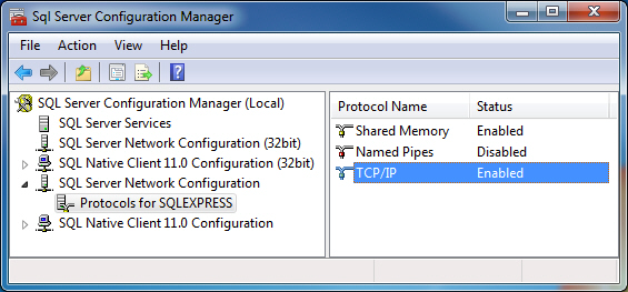

To check if TCP/IP is enabled​
  1. Open the SQL Server Configuration Manager from Start > All Programs > Microsoft SQL Server Version # > Configuration Tools > SQL Server Configuration Manager
    The SQL Server Configuration Manager window will be displayed.
  2. To see all the instances setup on that machine, expand SQL Server Network Configuration.
  3. Find the database (or instance) you plan on using. To the right, all of the protocols the database supports are shown. Find the TCP/IP protocol and select it.
  1. Make sure the Status next to TCP/IP is Enabled. If not, double-click TCP/IP and choose Yes from the drop-down next to Enabled and click OK.

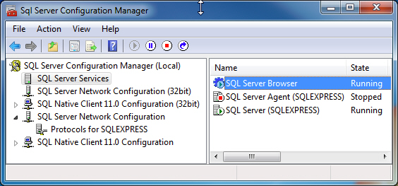

Check 2: Make Sure Microsoft SQL Server Browser is Running​
If you ARE connecting to your database using a NAMED INSTANCE, you must make sure that the Microsoft SQL Server Browser is running. As mentioned earlier, the Microsoft SQL Server Browser translates the instance name to a TCP/IP port in order for Ignition to connect to it.
To check if Microsoft SQL Server Browser is running​
Select the SQL Server Services section.
On the right, see all of the services installed. One of the services is SQL Server Browser. Make sure this service is in fact running. If the service is not running, right-click and select Start.
note
The service could be disabled, so you may need to double-click it to enable the service before starting it up.

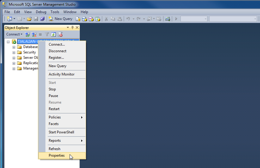

  1. Open the Microsoft SQL Server Management Studio window from Start > All Programs > Microsoft SQL Server Version # > SQL Server Management Studio
    The window is displayed showing connections to your database.

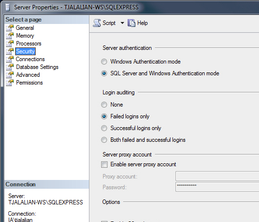

  2. Right-click the top-level database in the Object Explorer and select Properties.
  1. From the Server Properties window, on the left side, select Security.
  1. Verify that SQL Server and Windows Authentication mode is selected.
    If not, select it and click OK.

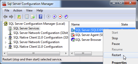

    Now you need to restart the SQL Server Windows service so that this setting takes effect.
  2. Open the SQL Server Configuration Manager at Start > All Programs > Microsoft SQL Server Version # > Configuration Tools > SQL Server Configuration Manager.
  3. Select the SQL Server Services section and restart the SQL Server (Instance Name) item.
