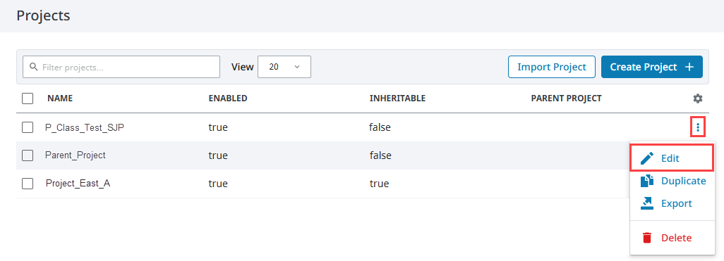

If you want to view or edit your project settings once your project is saved:
  1. Go to the Platform section on the Gateway Webpage and select System > Projects.
  2. Expand the three dots menu to the right of the project name and select Edit.
Now the Project Settings panel is displayed.

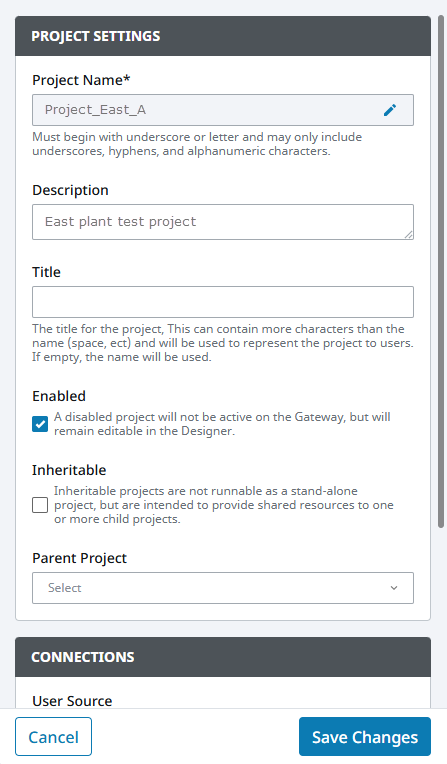

Project Settings Table
Project Settings
PropertyDescription
NameName of the project. Click the Edit icon to display the Rename Project form.
DescriptionBrief description of the project (optional). If the Description column is hidden in the settings, users can still view existing descriptions by hovering over the Information  icon next to the project name.
TitleTitle for the project (optional). This is the name that will be displayed on the launch page of the Gateway and in the runtime Client or Session. There are no restrictions to special characters or spaces. If no title is specified, the project name will be used instead.
EnabledA disabled project will not be active on the Gateway, but will remain editable in the Designer.
InheritableInheritable projects are not runnable as a stand-alone project, but are intended to provide shared resources to one or more child projects.
Parent ProjectEach project can have a parent project, and will inherit all of the resources of that parent project.

Once you have a project or two (or twenty) set up, you might want to change some of the base settings. You can manage the projects from the Platform section of the Gateway by going to System > Projects. The Projects page displays all your projects. To the right of the project name, click the three dot menu. Once expanded, you'll see all the actions you can take for your project, such as Edit, Duplicate, Export, and Delete your project.

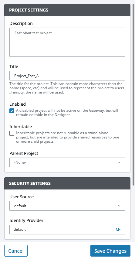

To view project settings, go to the Platform section of the Gateway, and then to System > Projects. You will see a list of all your projects. Click Edit to the right of project name in the list. The Project Settings panel is displayed with the project's current configurations. From here, you change the project settings, such as project Description, Title, Enabled, etc. You can also change connections to the User Source, Default Database, and Default Tag Provider. If changing any settings, click Save Changes.

Many of these settings can be modified in the Designer too, but it is important to note that you cannot change any of these project settings from the Gateway if the project is currently open in a Designer.

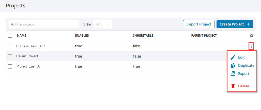

Be aware that once you delete a project, it cannot be undone, a deleted project is gone forever (unless it can be recovered from a project export, or a Gateway backup). Always make a project export or Gateway Backup before deleting a project. To delete a project, go to the Platform section of the Gateway, and then to System > Projects. You will now see a list of all your projects. To the right of the project name in the list, expand the three dots menu and click Delete. This deletes your project.

Copying your project is useful when you need a snapshot of a project before starting major changes, or for creating a starting point for a new project based on an old one. To duplicate a project, go to the Platform section of the Gateway, and then to System > Projects. You will now see a list of all your projects. Expand the three dots menu to the right of the project name in the list and click Duplicate. This creates a copy of your project.

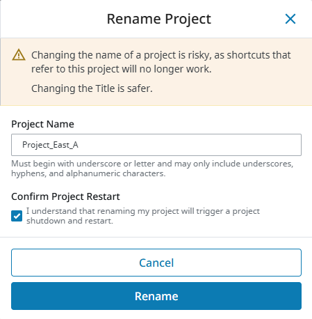

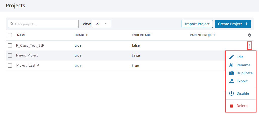

Changing the name of a project is risky. Shortcuts that refer to the project will no longer work. It is advisible to change the Title which is much safer. If you decide to rename a project, go to to the Platform section of the Gateway and then to System > Projects. Expand the three dots menu to the right of project name in the list and click Edit. In the Name field on the Project Settings panel, click the Edit icon. This will open a Rename Project form. Read it carefully, and if you want to proceed, enter a new project name, mark the checkbox acknowledging that the project will shutdown and restart, then click Rename.
note
Renaming a project triggers a project shutdown and restart.
Exporting a Project
Project Export creates a project backup as a .zip file. It takes less time than a Gateway backup and it's smaller. Once you have an exported file of your project, you can take it to any other Gateway and merge it in with other projects. Refer to the Project Export and Import page to learn exactly what is included in a project export.
