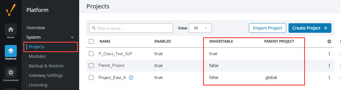

  1. Go to the Config tab on the Gateway Webpage, and select Systems > Projects. This brings up a list of all your projects. You'll notice that for each project listed, you'll see at a glance if a project is Inheritable, and if so, the name of the Parent Project will be displayed.
  2. Find the project you want to make inheritable, and click the three dot menu and select Edit (i.e., global) to open the Project Settings panel.
  3. Enable the Inheritable property, and click Save Changes.
