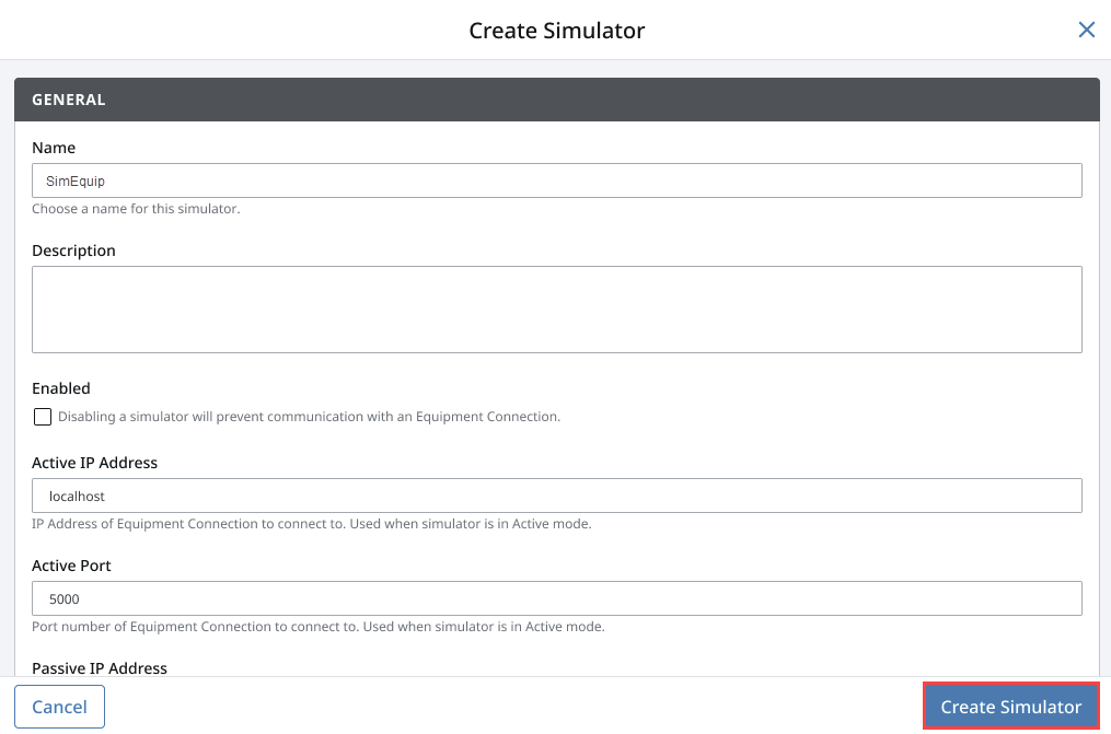

Configuring the Simulator
The SECS/GEM module can directly interact with a piece of equipment, but we can also use the built-in simulator. This tutorial will assume you are using a simulator. To configure a simulator, refer to the example below.
Example - Setting Up the Simulator
The instructions below will walk you through configuring the simulator. Most of the vaules can be left as defaults to get you up and running quickly.
Go to the Gateway webpage and select Connections > SECS/GEM > Simulator.
On the Simulator page of the Gateway, click on the Create Simulator + link.
- Name - enter the simulator name (ie., SimEquip).
- Active Port - use the default port number of 5000. The port number needs to be unique if you're using multiple simulators.
- Passive Port - use the default port number of 5000. The port number needs to be unique if you're using multiple simulators.
- Device ID - use the default ID of 0. Each piece of equipment must have a unique device ID, and must be an integer.
- Connection Mode - use the default Passive mode. The Connection Mode is a property that is configured in both the Simulator and Equipment Connection settings, and cannot be set to the same method. Alternating mode can be used, in which case, it will switch between Active mode and Passive mode until a connection is made.
Click Create Simulator once you entered all your configuration settings. The window will refresh telling you the simulator was created successfully, and the status will toggle back and forth between "Connecting" and "Not Connected" until an equipment connection is created.
For more information on configuring a simulator, refer to the SECS/GEM Simulator page.

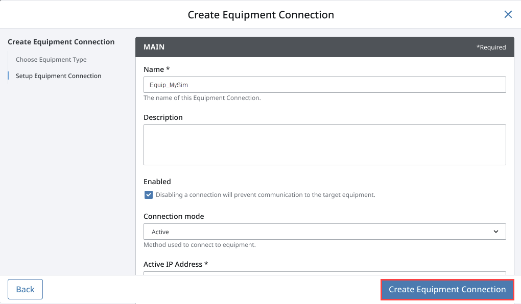

Creating an Equipment Connection
Once the simulator is configured, (or if there is an actual piece of equipment you wish to connect to), a connection to the Equipment must be made on the Connections > SECS/GEM > Equipment section of the Gateway Webpage.
When creating the equipment connection, most of the settings can be left as the default values for this tutorial. Use the following instructions to configure the equipment connection.
On the SECS/GEM Equipment page, click on Create Equipment Connection +.
On the Choose Equipment Type form, select Ethernet/HSMS Connection, and click Next.
On the Setup Equipment Connection form:
- Equipment Name - enter the equipment name (i.e., Equip_MySim).
- Enabled - default set to true. Enables communication to the target equipment.
- Connection Mode - use the default Active mode.
- Active IP Address - use the default of localhost.
- Active Port - use the default port number of 5000. The Active Port number must match the port number used in the simulator configuration setup (i.e., 5000).
- Passive IP Address - use the default of localhost.
- Passive Port - use the default port number of 5000. The Passive Port number must match the port number used in the simulator configuration setup (i.e., 5000).
- Device ID - the default ID is 0. Each equipment requires a unique identifier, and must be an integer.
- Database Connection - enter the database connection name (i.e., SecsGem). This is the database name that was configured in Configuring the Database Connection step.
- Database Table Prefix - enter a table prefix (i.e., Sim_). This is the prefix that will be prepended to each of the database table names that are automatically setup when the connection is made. If no prefix is specified, the table will still get created. The advantage of using a prefix is it helps keep database tables organized, and it is used to differentiate one equipment's tables from another equipment's tables. It also allows you to filter a project based on the prefix.
- SECS Definition Language (SDL) File - use the default file messages.sdl. Validates sent and recieved messages.
Once all the configuration settings are entered, click Create Equipment Connection.

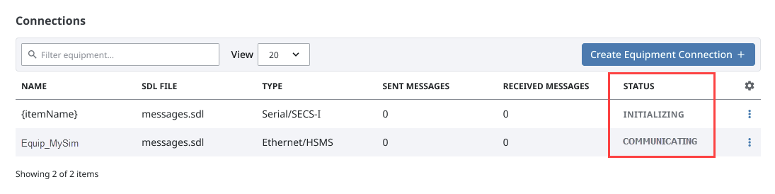

The Equipment Connection will try to connect to the simulator that you setup in Configuring the Simulator section. The window will refresh showing a status of "Connecting" until the equipment connection is created.
More information connecting to a tool can be found on the SECS/GEM Equipment Connections page.
Equipment Connection Status
The status of the Equipment Connection is shown in the Status column on the Equipment Connections webpage. When the status changes to "Communicating", the Equipment Connection successfully connected to the simulator.
