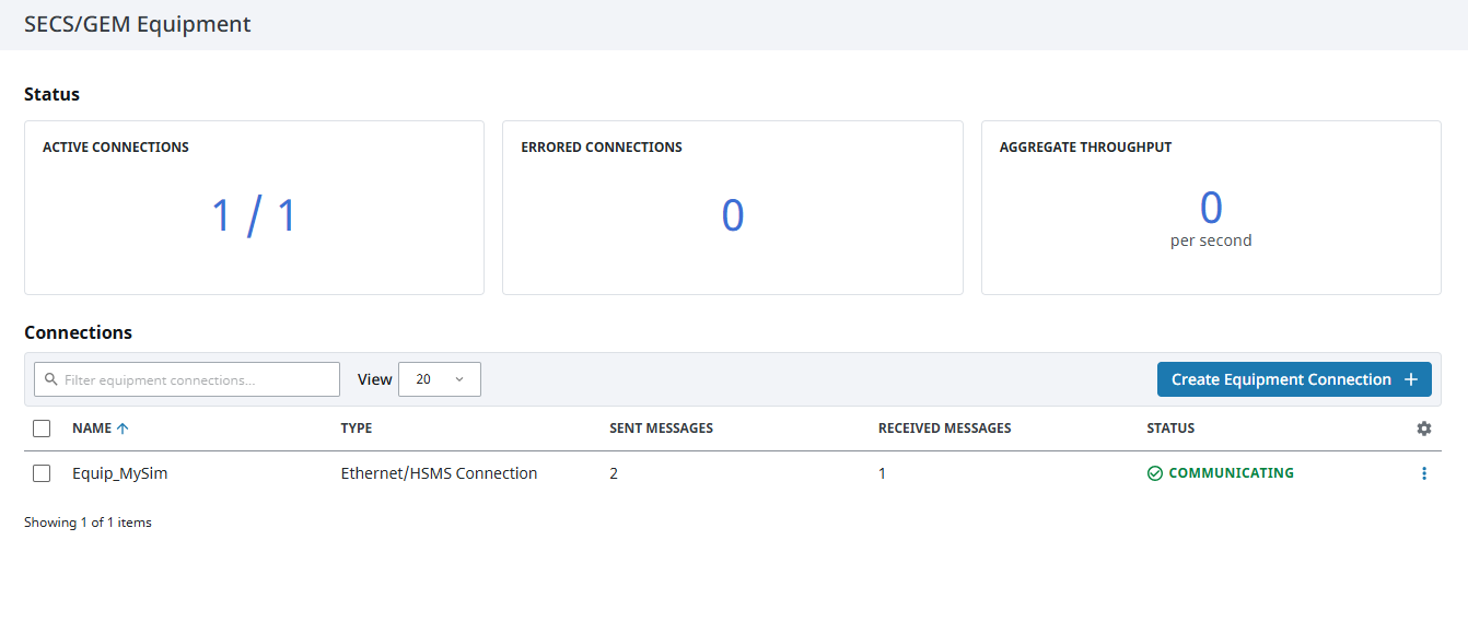

Once all the configuration settings are entered, click on the Create Equipment Connection.
The page will refresh showing a status of Connecting until the equipment connection is created. When the status changes to Communicating, the Equipment Connection is successfully created.

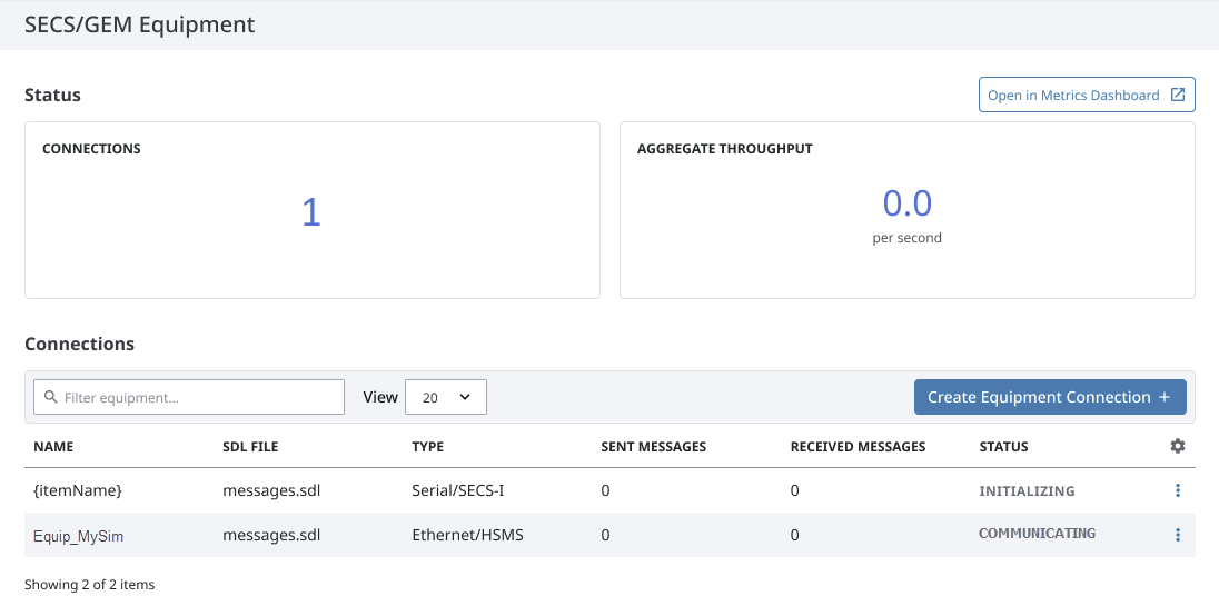

SECS/GEM Equipment Page
The SECS/GEM Equipment page displays a list of all equipment connections, their status, as well as the number of sent requests and received messages. If any piece of equipment becomes faulted, it will show a status of "Not Connected".
The SECS/GEM Module is not standard and will be missing for most installs of Ignition. The SECS/GEM Equipment page will only be displayed when the module is installed.
The SECS/GEM Equipment page lists out all equipment connections and displays the number of messages sent between them and Ignition.
| Attribute | Description |
| Connections | The total number of active SECS/GEM Equipment connections. |
| Aggregate Throughput | The messages per second the system is sending and receiving from all devices at that time. |
| Name | The name of the equipment connection in the list. |
| Sent Messages | The number of messages sent to the equipment. |
| Received Messages | The number of messages received from the equipment. |
| Status | The status of the equipment. |

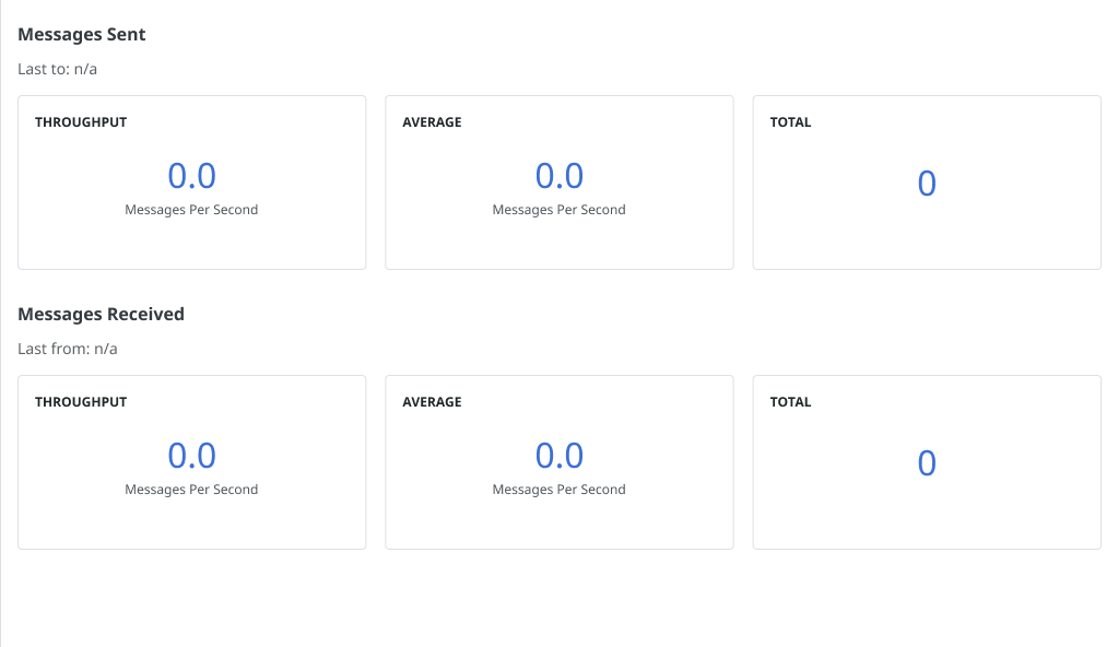

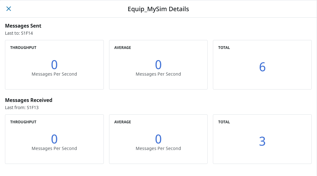

SECS/GEM Equipment Details
Expanding the three dots menu and selecting View Details to the right of a piece of equipment will take you to a page that shows more detailed information for that particular piece of equipment.
Messages Sent
| Throughput | The messages per second the system is currently sending. |
| Average | The average messages sent per second from when the equipment was first enabled. |
| Total | The total messages sent. |
Messages Received
| Throughput | The messages per second the system is currently receiving. |
| Average | The average messages received per second from when the equipment was first enabled. |
| Total | The total messages received. |
