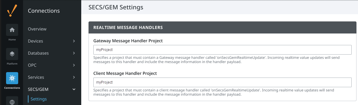

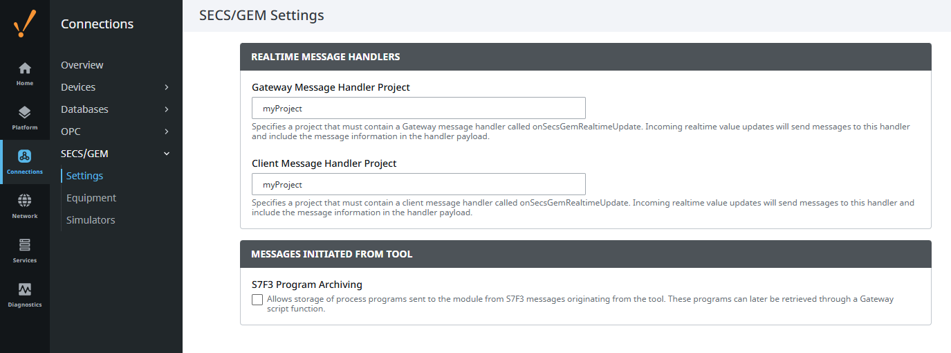

Once an onSecsGemRealtimeUpdate Message Handler has been specified, it needs to be specified within the Gateway. Within the Gateway Webpage Connections section, the Settings page under the SECS/GEM header will have Properties to specify which project holds the Gateway Message Handler and which project holds the Client Message Handler. These can be the same project or different projects.
Example with S2F14 using the Simulator
This example sets up the S2F14 message to call the Gateway Message Handler that we setup. It assumes the equipment connection is made to a simulator with the default SDL file. In order to capture message with the onSecsGemRealtimeUpdate, the SDL File will need to be configured to allow that. Here we set up the SDL File to have S2F14 to go through the message handler.
  1. Create a Gateway Message Handler called onSecsGemRealtimeUpdate.
  2. Go to the Gateway Webpage Connections section, and navigate to the SECS/GEM > Settings page.
    1. Specify the project that the Gateway Message Handler was created on in the Gateway Message Handler Project setting.
  3. Navigate to SECS/GEM > Equipment.
    1. On the equipment connection, expand the three dots menu and select Edit File.
  4. Locate the S2F14 message in the list.
    1. Add "realtime" as an Auto type object with a value of "true" directly under the S2F14 root.
    2. Create an array called "CommonID" directly under the S2F14 root.
      1. Add "0: ECV" to the CommonID array as an Auto type object.
  5. Save the SDL file and restart the equipment connection.

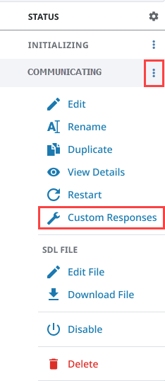

Once a Message Handler has been created, the equipment connection needs to specify that it will be using that as a custom message response. To do this, navigate to the Gateway Webpage Connections section, navigate to SECS/GEM > Equipment. For the equipment connection, click the three dot menu to display options. Select Custom Responses.
On the Message Response Handlers page, we can setup a link between the stream function response we want to intercept and which Message Handler will be used to handle it. Each Message Response Handler has the following settings.
SettingDescription
EnabledIf true, the specified script message handler will be fired when the specified StreamFunction is encountered.
Intercept Stream FunctionThe SECS stream and function type of the message that will be intercepted. Use a value such as "S6F2"
Gateway Message HandlerThe name of the script message handler that will create the SECS response message. This message handler must be created in a project to provide custom responses, and must be a Gateway Event Script message handler.
Project NameThe project that contains the script message handler specified above.
