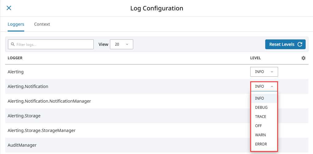

Each Equipment Connection has a logger associated with it. The Equipment Connection loggers and their severity level can be seen in the Diagnostics section of the Gateway Webpage under Logs. By default, only messages with a severity level of INFO or more severe such as WARNING or ERROR are logged. A lot of data about what an Equipment Connection is doing can be logged by changing the log level of the Equipment Connection to a less severe level. At the TRACE log level, all SECS messages sent and received by an Equipment Connection are logged.
To change the severity level of a logger, click the Settings button to open the Log Configuration panel. Locate the logger you want change, click on the dropdown arrow, and select the severity you want to update.
