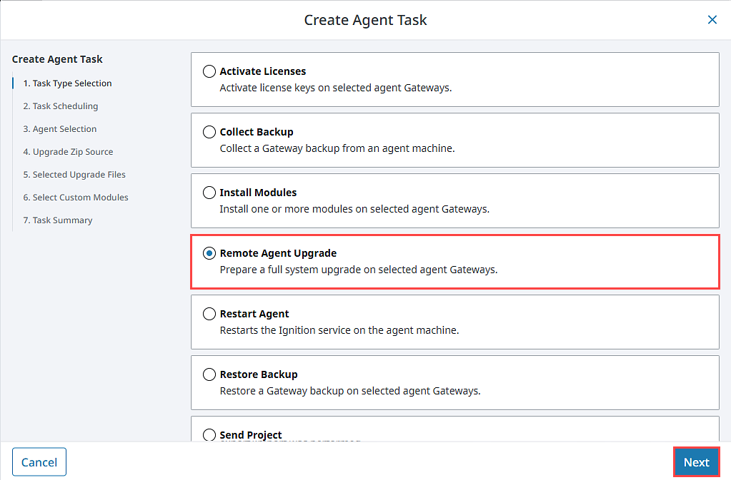

  3. Select the Remote Agent Upgrade task from the list of tasks, and then click Next.

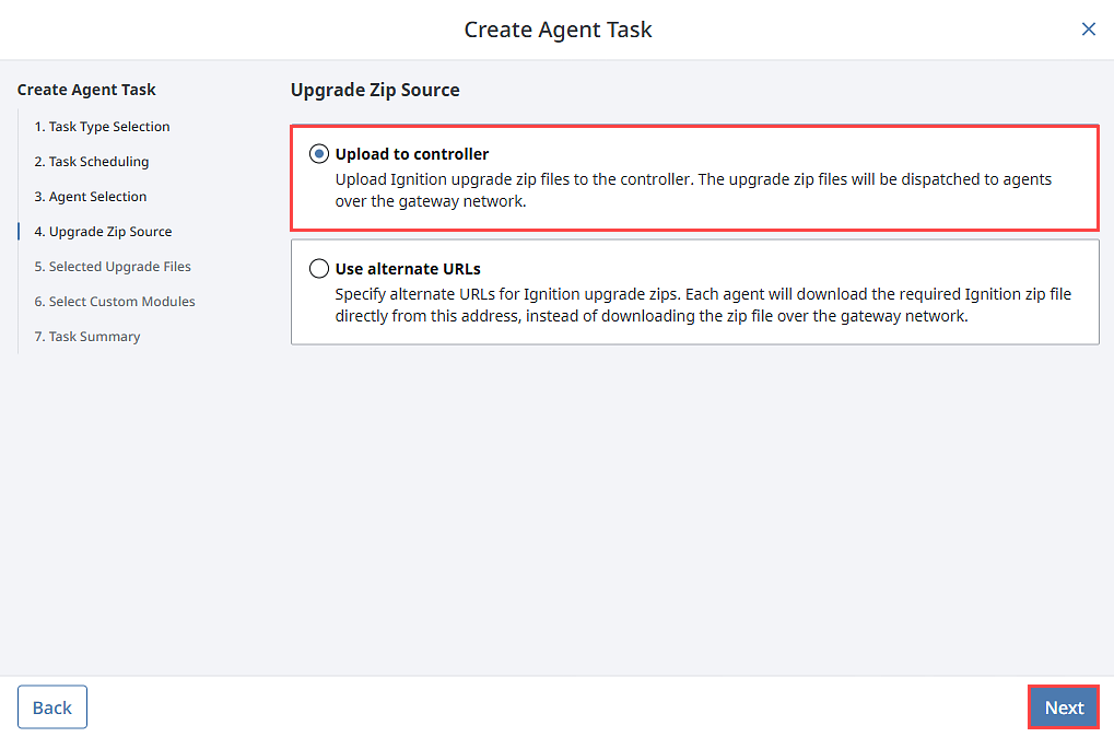

  7. Select how you want to upgrade your controller. You can either choose to upload the Ignition upgrade zip files to dispatch to connected agents, or specify an alternate URL that the agent will use to download the required upgrade zip files. In this example, we will choose Upload to controller. Once you have made your choice, click Next.
