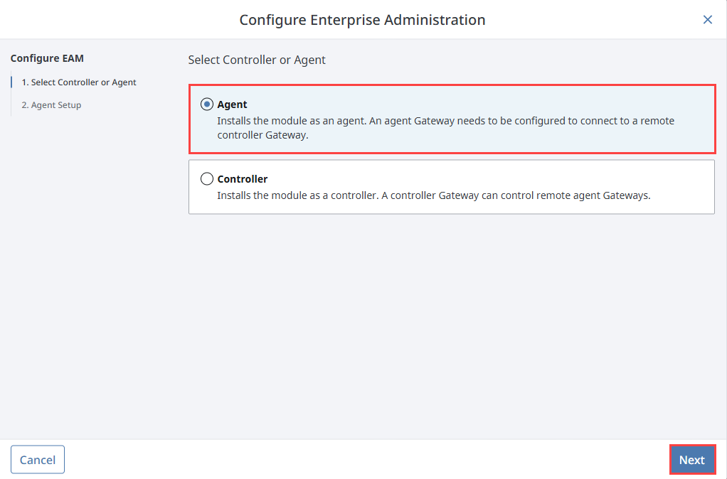

  1. On the agent Gateway, install Ignition and make sure the EAM module is also installed. It is added by default if you select Typical during installation.
  2. Go to the Network section and select the Enterprise. The EAM wizard will walk you through each step of the Agent Recovery process. Select Agent to configure and click Next.

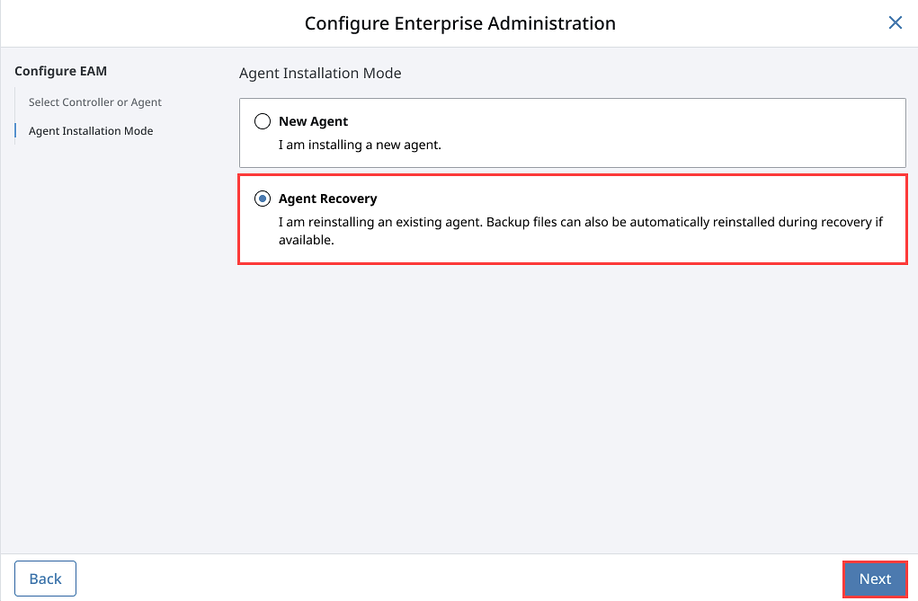

  3. In order to continue with the Agent Recovery procedure, you must have a backup collection of the agent. When you initially set up your agent on the controller, you created an Archive Path where the backup files are stored. EAM will automatically know where to retrieve the backup files. Click on Agent Recovery and click Next.

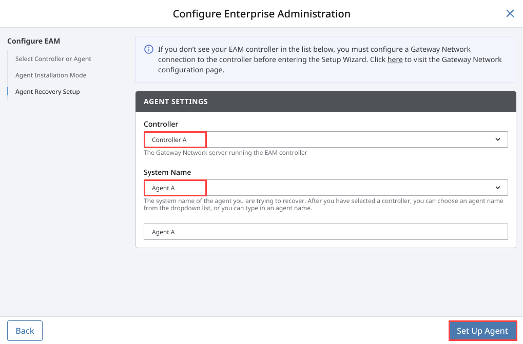

  4. For this example, we are recovering Agent A, and since Agent A existed previously, the EAM remembered the agent’s prior settings. You can select the controller and agent from the list of names in the dropdown, or type the names in. Click Set Up Agent.

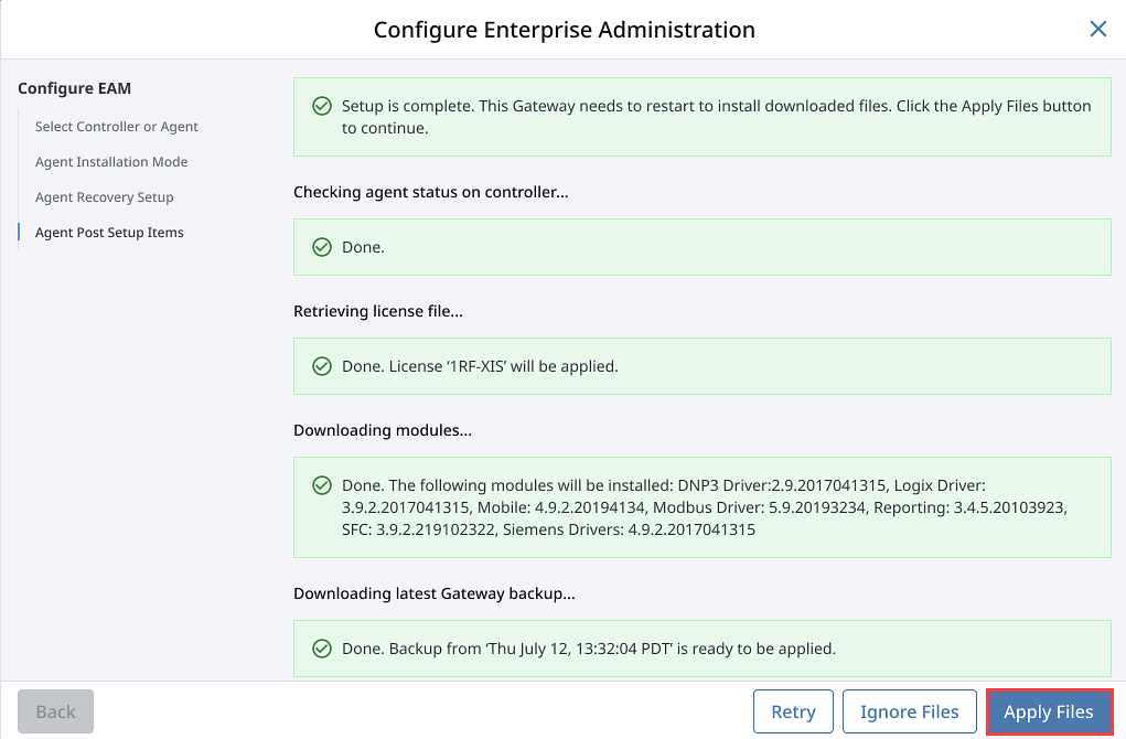

  5. The agent will go through a series of steps:
    1. Check the agent status on the controller.
    2. Retrieve the Ignition license file.
    3. Download Ignition modules.
    4. Copy the latest Gateway backup to the agent.
    When you get a message that the setup is complete, click Apply Files. You will see a message stating the Gateway is starting. It will take about a minute to bring the Gateway up.
    Once the files have been applied, you will see a message stating the Gateway is starting.

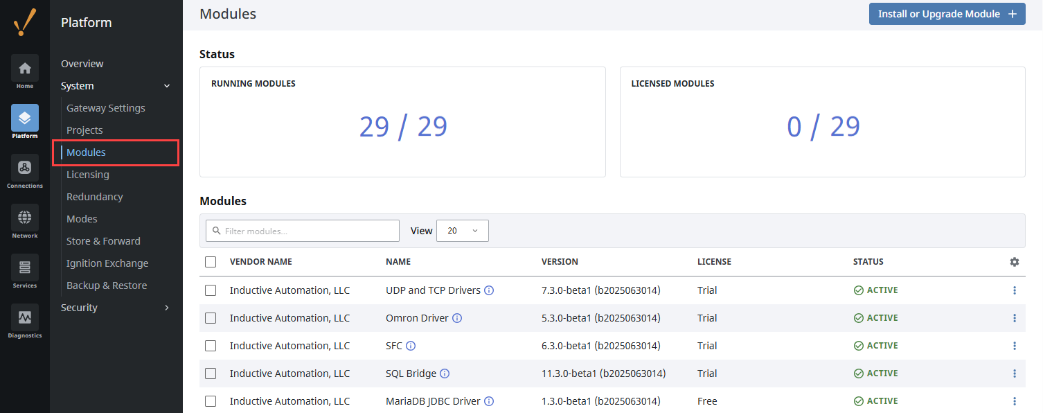

  6. The screen will refresh once the Gateway is up and running. Go to the Platform section of the the Gateway webpage, and click on System > Projects. You will see that all your projects were recovered.
  7. It's also a good idea to verify that all your modules are installed and running by selecting Modules.
