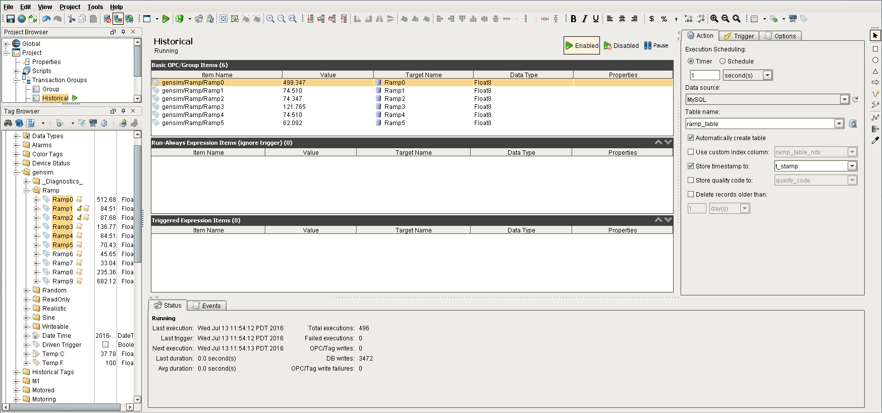

The module uses transaction groups that function as a bidirectional data bridge between an OPC server and a SQL database. Transaction groups can perform many data-centric tasks, such as event logging, vertical and horizontal data storage, inserting rows into a table, storing data to a specific row, and more.
Log Data Easily​
The easiest, most powerful data logger on the market includes triggers, handshakes, expressions, and other items that help you store data in the exact way you need. Triggers offer endless data-storage possibilities: storing production summaries, logging the sequence of event information, tracking downtime events, and more. Simply map your process data to any table structure and let the module do the work of creating and managing new tables or writing to existing tables.
