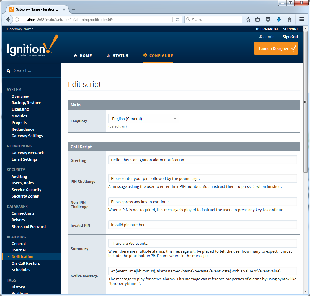

Two-Way Acknowledgement​
The Voice Notification Module can be configured to allow users to quickly acknowledge alarms. With the Two-Way property enabled, the notification is sent out a response code in the message. The user simply replies with the response code and the alarm will be acknowledged.
Custom Notification Messages​
The High-Quality Text-to-Speech Engine allows you to customize the alarm message the user hears, so you are not limited to a number of pre-recorded messages.
