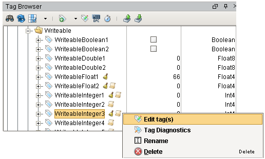

  1. Right-click on your Tag and select Edit tag(s). This example uses an OPC Tag, but any alarm-capable Tag will suffice.
    Creating Associated Data for both Static and Dynamic Properties Step 1

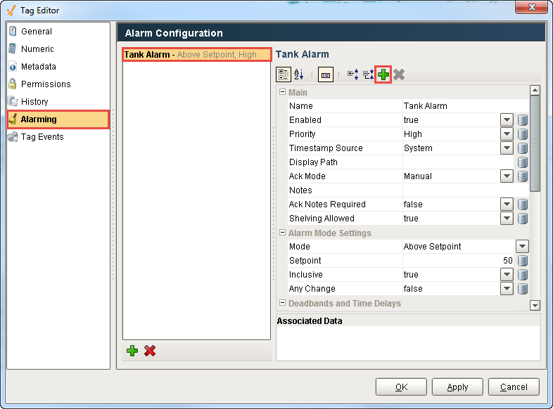

  2. In the Tag Editor, go to the Alarming tab, select an alarm. The Tag below already has an alarm named 'Tank Alarm', but you can create a new alarm for this example. Click the green plus sign + above the alarm properties to add new associated data for the alarm.
    Creating Associated Data for both Static and Dynamic Properties Step 2

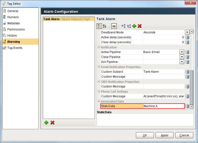

  3. Scroll to the bottom of the property list, and you'll see a new associated data property was added. By default, the new property name is called 'New Data'. Double-click the property name to rename it to something more meaningful, and press enter to submit your new name. In this example, make the associated data property a static value. Rename it to 'StaticData' with a value of 'Machine A'.
    Creating Associated Data for both Static and Dynamic Properties Step 3

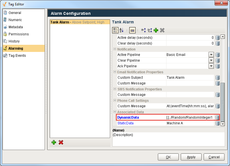

  4. Now, let's create another Associated Data property with a dynamic value. Click the green plus sign + above the alarm properties. Scroll down to the bottom of the property list and rename your 'New Data' property to 'DynamicData' and bind it to a Tag using the binding icon on the right side of the window (this example is using the RandomInteger1 tag from our Simulator). Click the 'Back' button in the upper left to submit the Tag selection.
    Creating Associated Data for both Static and Dynamic Properties Step 4

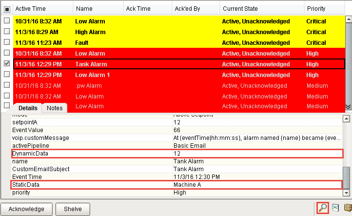

  5. Click OK. Now, when the alarm goes active, Ignition will store the values of the associated data with the alarm. You can view the details of the alarm in the Alarm Status Component along with the new associated data properties. To view the Details of the alarm, check the box of the alarm you want to see, and click on the magnifying glass at the bottom of the window.
    Creating Associated Data for both Static and Dynamic Properties Step 5

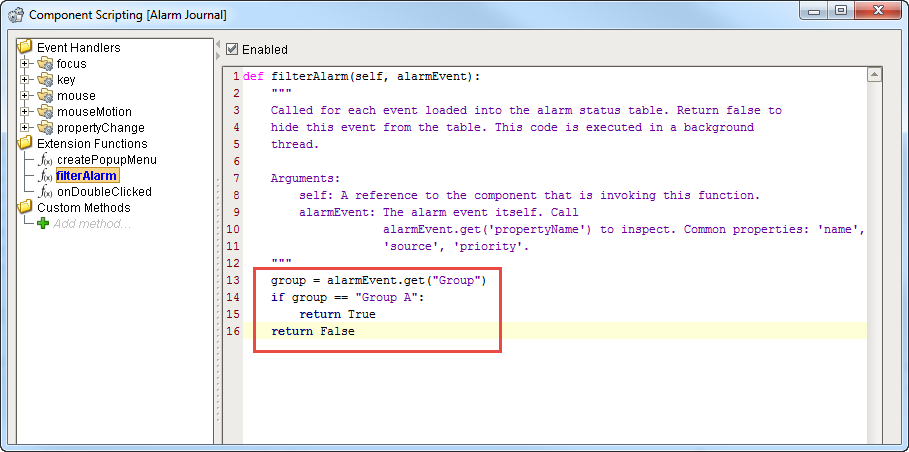

  5. Before you can use the Alarm Journal to filter on your new associated data property, edit the 'filterAlarm' Extension Function to include your new associated data property.
    Select the Alarm Journal component, scroll down and right click on Scripting. Under Extension Functions, click on filterAlarm. Click on the Enabled checkbox to enable the script. Next, edit the script to add your new associated property and property value. Refer to the new code below to add to the filterAlarm script
    filterAlarm Scripting Function
    group = alarmEvent.get("Group")
    if group == "Group A":
    return True
    return False
    Creating an Alarm Grouping Step 5
