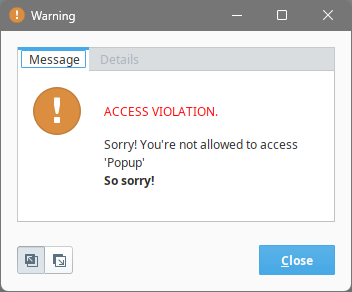

  4. When a user without the proper permission attempts to access the popup from the client, they will get the following message.

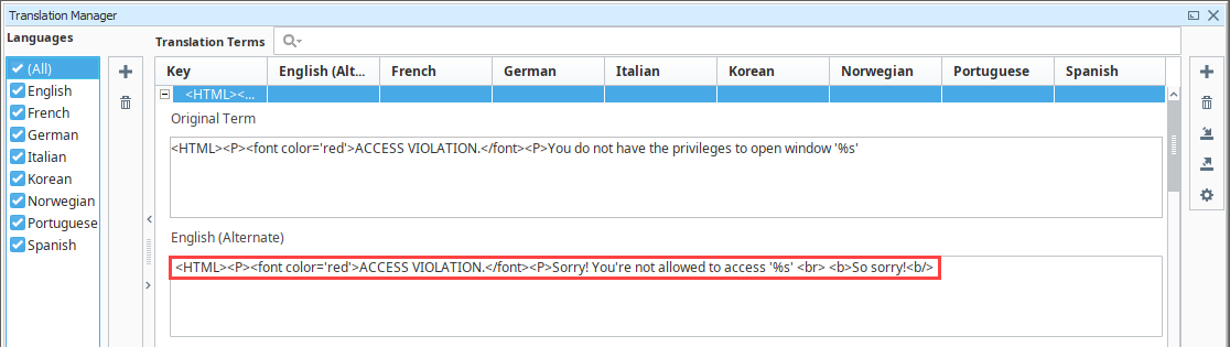

Using the same example from above, we modified a version of the text that appeared in the message box. We used the English (Alternate) as the language where the name of the window is passed into the message box via the '%s' substring.
  1. Copy the new message from the code block below.
    Access Violation - Translated Term
    <HTML><P><font color='red'>ACCESS VIOLATION.</font><P>Sorry! You're not allowed to access '%s' <br> <b>So sorry!<b/>
  2. In the Transaction Manager window, double click the row for the Key and paste it in the English (Alternate) field. Click Save.
  3. Save your project. Now, our message box appears as the following when a user does not have the proper access.
