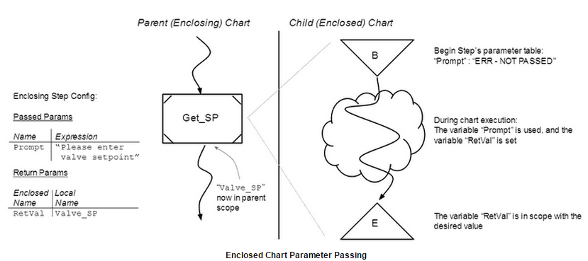

Parameter Passing​
When invoking a subchart via an enclosing step, you have the opportunity to define how variables are passed and returned between the parent and child chart’s scopes.
The enclosing step can define a list of parameters to be passed into the enclosed chart’s scope. The values for the parameters will be expressions, thus they can be literal values or they can be references to variables in the enclosing chart’s scope.
The enclosing step can also define a list of return values to receive from the enclosed chart. This is a mapping of variable names from the enclosed chart’s scope to variable names in the parent chart’s scope.
New in 7.9.8
Return values can now be mapped to Chart Scoped Variables by using the same syntax that they would in the passed parameters.
