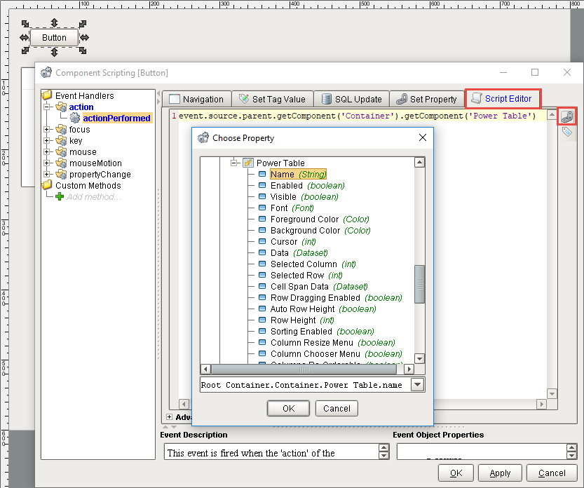

  1. As mentioned above, if the Button and Table are in separate containers, the path will be different. Double click the Button component, and use the Property Reference button to generate the path to a property, but not the component.
  2. Select a property from the Power Table in the Choose Property window and click OK.
  3. Remove the ".propertyName" portion at the end of the script in the Script Editor, and click OK.

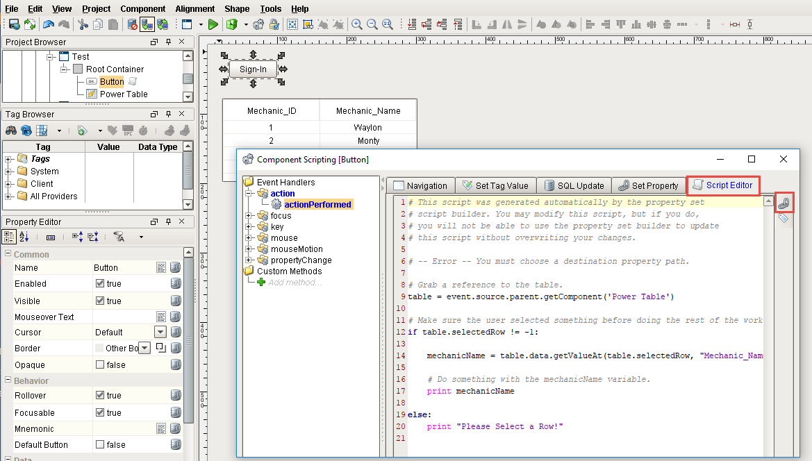

Here is all the code that you'll need to read a single cell from a Power Table in the same container.
Python - Putting it all Together
# Grab a reference to the table.
table = event.source.parent.getComponent('Power Table')
# Make sure the user selected something before doing the rest of the work.
if table.selectedRow != -1:
mechanicName = table.data.getValueAt(table.selectedRow, "Mechanic_Name")
# Do something with the mechanicName variable.
print mechanicName
else:
print "Please Select a Row!"

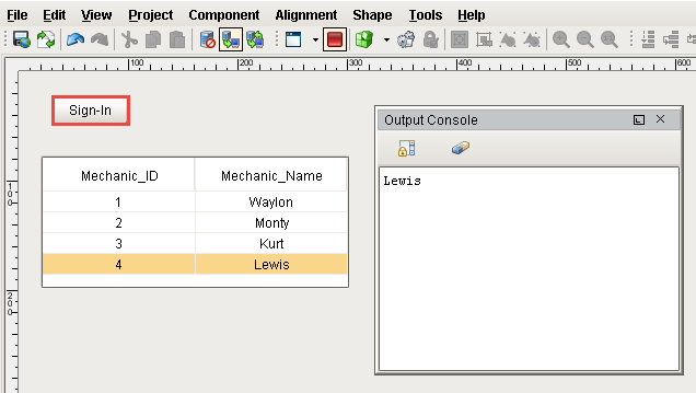

Test Your Script​
Now you're ready to test your script.
  1. Open the Output Console and select Tools > Console in the menubar.
  2. In Preview Mode, select a row in the Power Table, and press the Sign-In button. You will see the selected Mechanic_Name displayed in the console.
