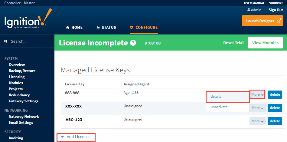

License Details​
You can click on the details link on the right side of each license to view modules and versions currently assigned to the license. Note that the information displayed on the License Detail page reflects the license as it appears on file at Inductive Automation. This functionality allows you to confirm exactly which modules and versions are currently assigned to a license.

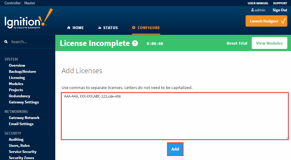

Preloading Licenses​
You can preload a list of license keys in the controller. After the license list is loaded, you can individually assign licenses to agents, or assign all free licenses to agents in one step via the Activate License task.
  1. To preload a license list, navigate to the Enterprise Administration > License Management page, look for the blue arrow, and click the Add Licenses link.
  2. Enter the license keys. Use commas to separate the licenses. The formatting is shown below:
    AAA-AAA,xxx-xxx,ABC-123,cde-456
  3. Click the Add button to save preloaded licenses.

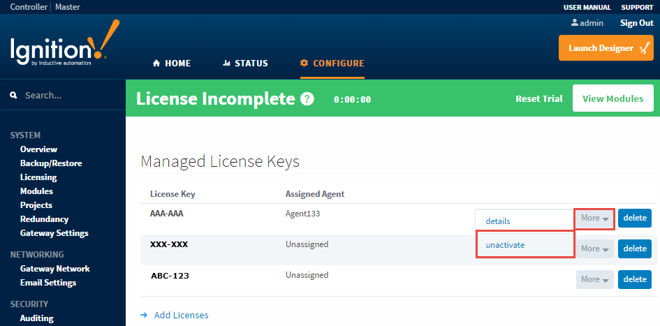

Deleting Licenses​
You can remove unused licenses from the License Management page, but only if the license is not currently assigned to any agent. If you want to delete an assigned license, click the unactivate link on the right side of the license. After the Assigned Agent field changes to “Unassigned,” you can delete the license.
