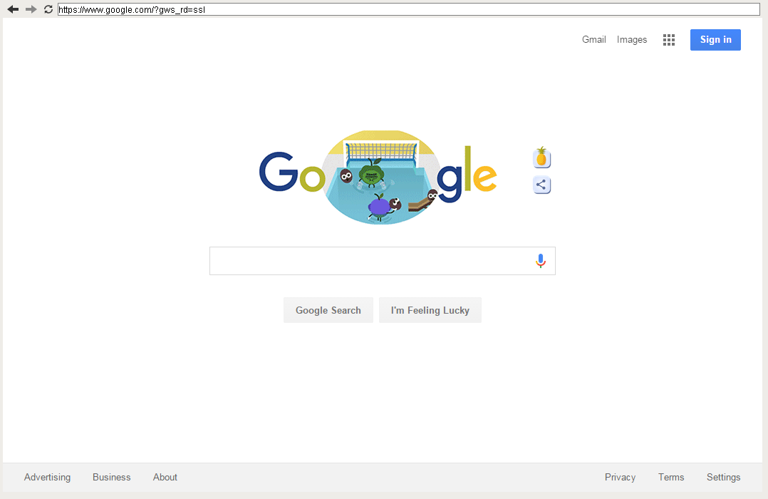

The Web Browser component in Designer allows you to embed a full web browser inside of an Ignition Client. This component becomes available in Designer after you download the Web Browser module from the Inductive Automation's website. The Web Browser module installs the same way as any other modules. Once this component is added onto a window, it will behave just like any other web browser when it is inside a Client.
