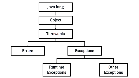

Java Exceptions​
Although scripting in Ignition is done in Python, system library functions may also throw Java exceptions, since Ignition is written in Java. The Python scripts demonstrated above will not catch these, because Jython models Java exceptions as an entirely separate exception hierarchy. Importing Java's Exception class with java.lang.Exception will catch most exceptions thrown in Java code, excluding only "unrecoverable" errors such as OutOfMemoryError.
Pseudocode - Exception Class
# Import the Exception class
import java.lang.Exception
# With try, we can attempt any amount of code
try:
code you want to test
more code
code that will throw an exception
# If any of lines in the try block were to throw an error, then we move down and run the block under except.
# The except statement is NOT optional
# You must define what your code should do in the event an exception occurs.
except java.lang.Exception as e:
failover code
Ultimately, all Java exceptions and errors inherit from the Throwable class, so you can choose to intercept even normally unrecoverable errors such as StackOverflowError or OutOfMemoryError by widening your except clause to Throwable.
Pseudocode - Throwable Class
from java.lang import Throwable
try:
more code
except Throwable as t:
failover code
except Exception as e:
failover code
