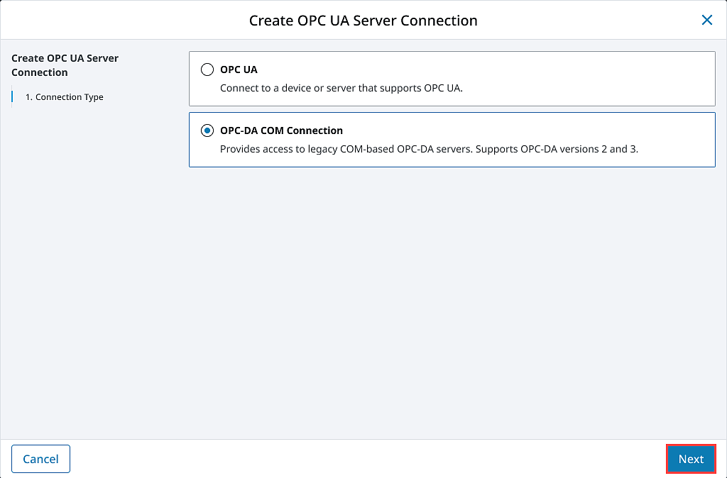

Connecting to OPC DA Server​
With the OPC Core Components now installed, the next step is creating a new OPC DA server connection.
Install OPC DA Server Connection​
  1. Go to the Ignition Gateway Connections section.
  2. Go to OPC > Connections, and then select Create OPC Connection.
  3. Choose the OPC-DA COM Connection and click Next.

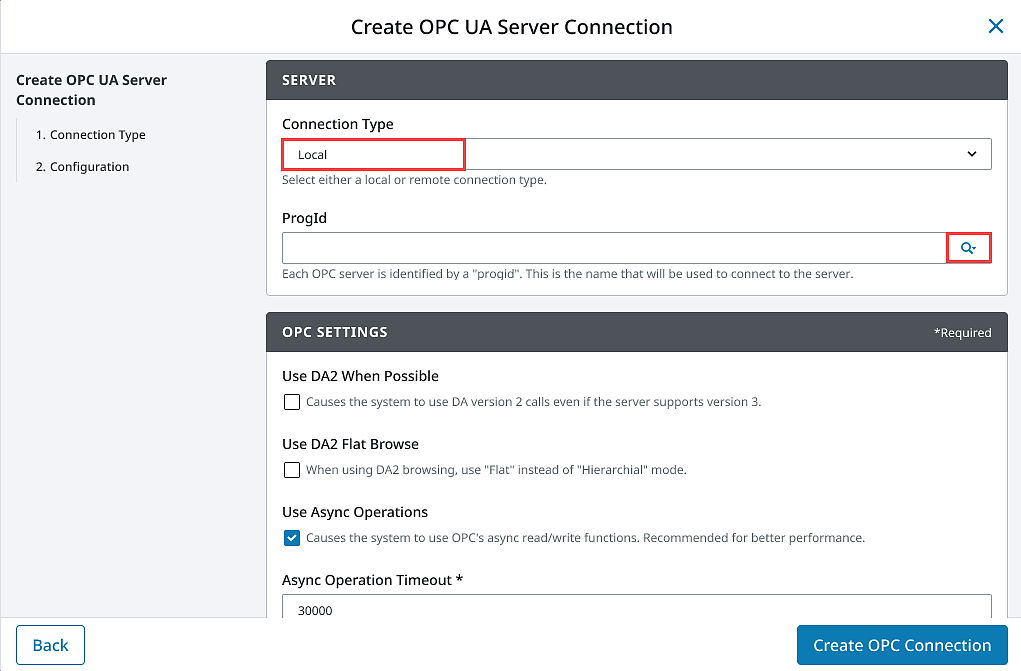

  4. Enter the name for your connection.
  5. Under Server, select whether you want to make a Local connection, or a Remote connection if the OPC server resides on machine. For the most part, setting up a local or remote connection to an OPC DA server is the same. There are only a couple of differences for a remote connection.
    • Local: Selecting a local connection displays a dropdown selection with a list of the available and running OPC servers located on the local machine.
    • Remote: Selecting a remote connection additionally displays a Host Machine setting where you will specify the host name or IP address of the machine the OPC server resides on, which will update the server list under ProgId. Optionally, you can also enter the CLSID of the server. This id can be found in the registry of the machine hosting the server under: HKEY_CLASSES_ROOT\OPCServerName\CLSID.
  6. Select the OPC server you wish to connect to from the list. In the case where your server is not listed, you can manually enter the ProgId.
  7. When you are finished fine tuning the settings, click Create OPC Connection. You will be redirected to the OPC UA Connections page and your new server connection should be listed. The status of your connection will read Connected if Ignition was able to successfully connect to the third party OPC server.
