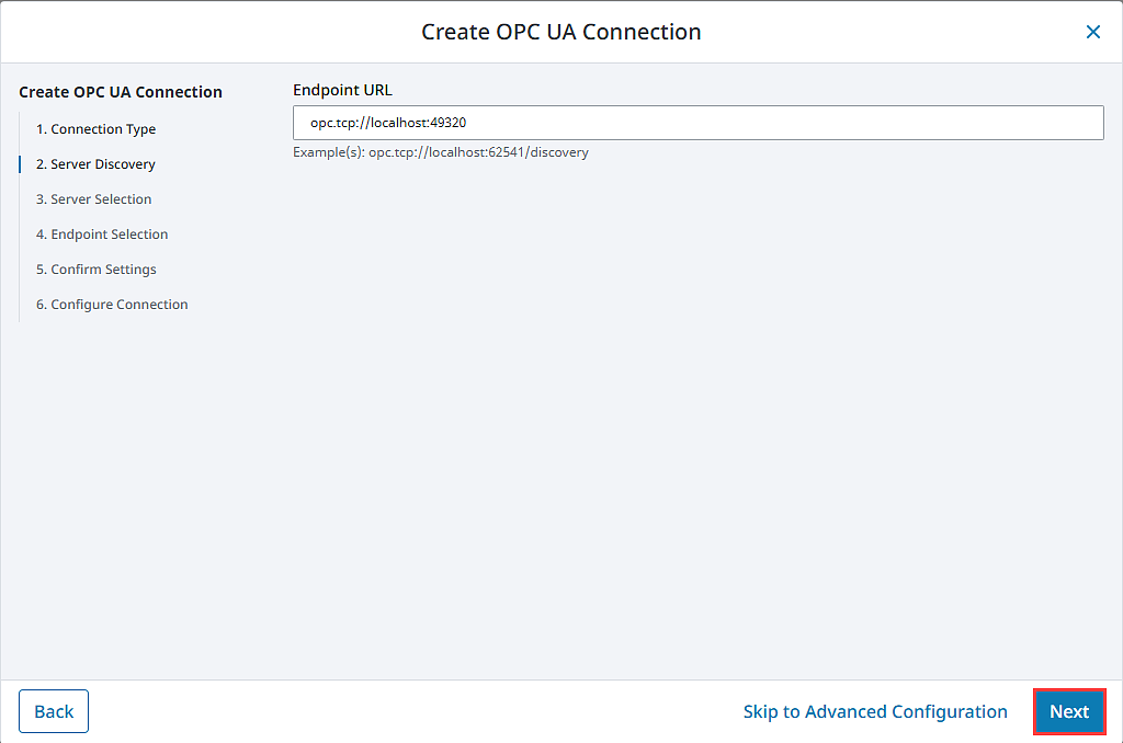

  4. On the Server Discovery page,enter the endpoint of the OPC UA server Ignition should connect to. For example:
    Sample FormatLocalhost Example, Default PortRemote Example, Custom Port
    opc.tcp://IpAddress:Portopc.tcp://localhost:49320opc.tcp://10.1.1.10:4444
    Click the Next to continue.
    Connect to KEPServerEX Step 4

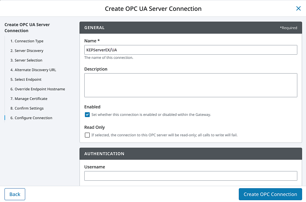

  9. This takes you to the new OPC Connection form. Fill in the Username and Password if your KEPServer connection requires it.
    Most current installations of KEPServer require a login and will not connect without one. See the No Anonymous Token Policy Found section below.
    Connect to KEPServerEX Step 9
  10. Click Create OPC Connection.

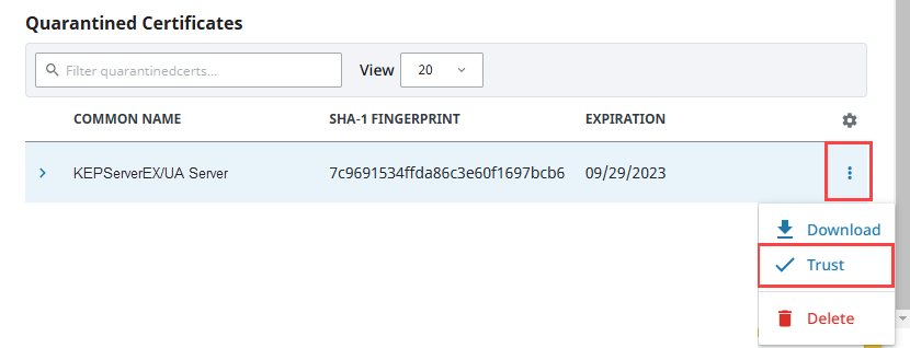

  16. Go back to the Ignition Gateway Webpage. In the Connections section, go to the OPC > Security page.
  17. Under the Client tab, you will find your new connection listed as Quarantined. Click on the three dot menu and select Trust.
    Connect to KEPServerEX Step 17
  18. Go back to the Connections section of the Gateway, to OPC > Connections. The status of your KEPServer connection should be Connected.
